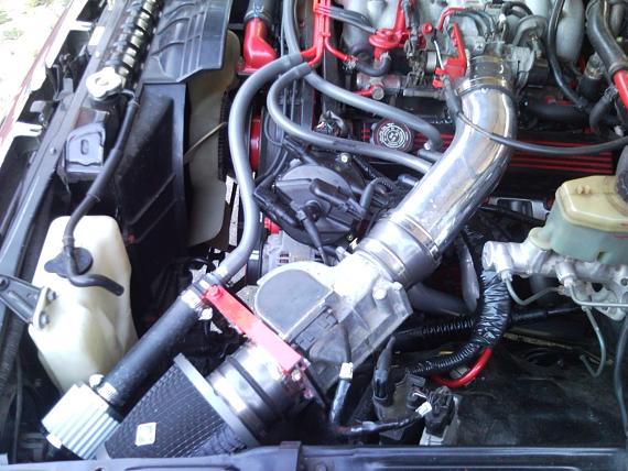

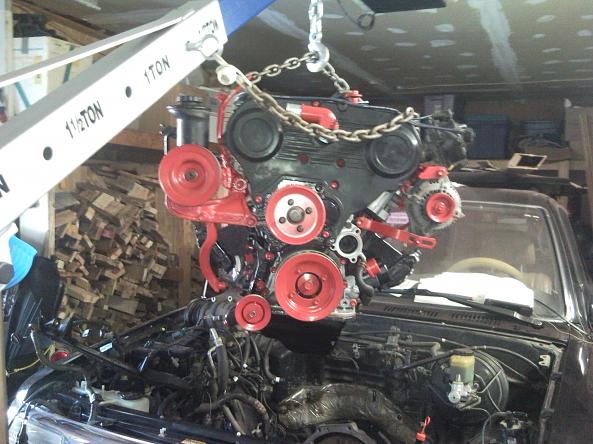

Attached Thumbnails Obscene timing?-snc00068.jpg   Obscene timing?-snc00019.jpg
