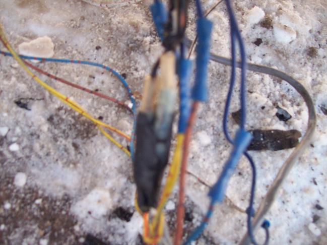

WELL, after rewiring the white, lt-blue and brown wire under the truck (there was about 10 old connections down there) and putting the COR back into its socket the truck started up and is still out there RUNNING!!! SO, I believe you may have been right about the ground/wire idea. THANKS!!!!!
This is the mess that WAS down there...
