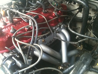

Hey guys, thought I would update you. So the header most definitely fits. Had to relocated the o2 sensor bung back to the original location, and drill out two new holes for the extra studs that the 22re model has (vs 22r).

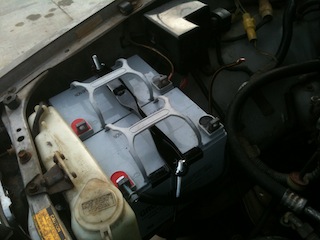

and set up a mini-dual battery set up (had the batteries laying around). Not sure if is any better or worse than a single large batter, Im just happy that they are sealed gel type, w/o maintance. The extra posts are nice to have too.
