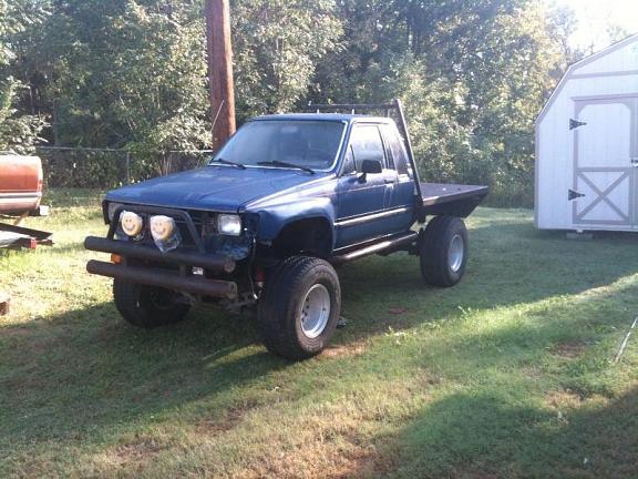

my toy...has detroit lockers front and rear, 4.56 gears, and suspension lift and body lift....runs good for over 170,00 miles on motor....
