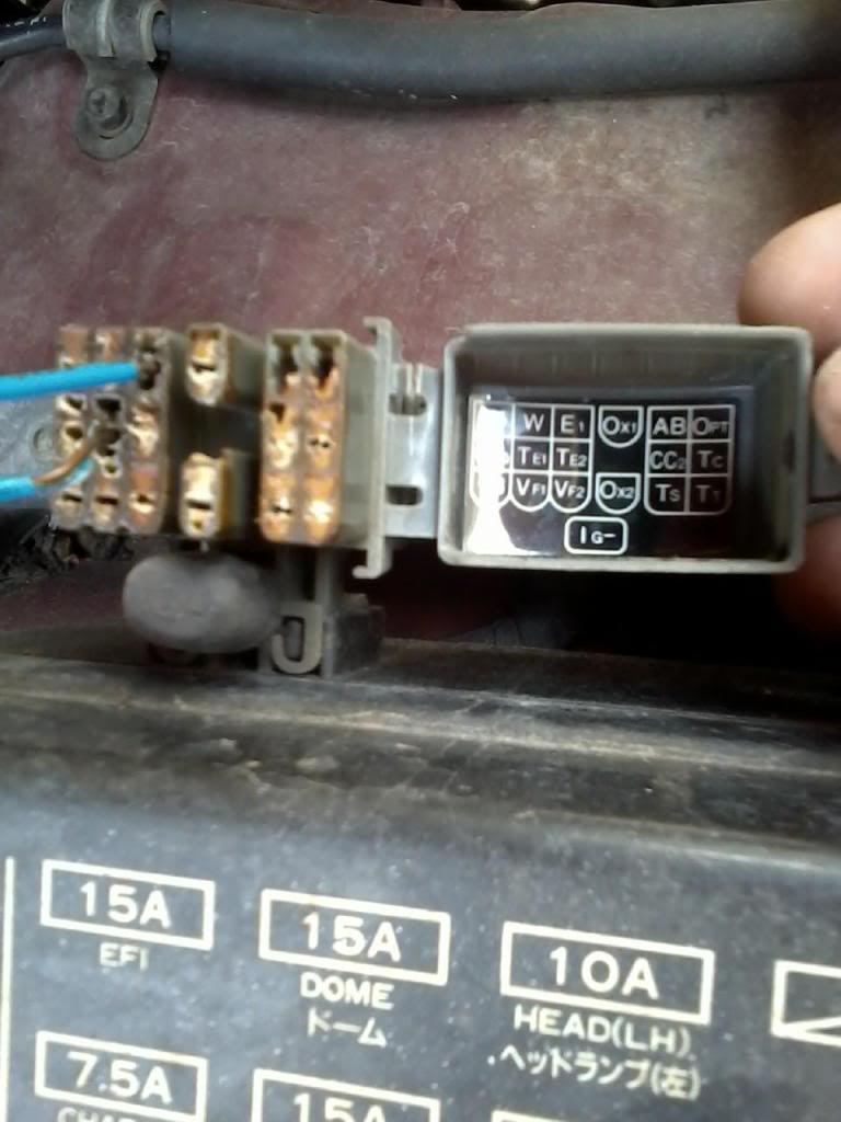

I need to ask a stupid question. Earlier in this thead it was mentioned bypass mode. What exactly does this mean. I have not heard about this while referring to timing of the engine?

Bypass mode is when you jump 2 contacts in the diagnostic box on the passenger side.
Old Jun 12, 2014 | 02:56 PM
  #27
snowbrdr's Avatar
Joined: Jun 2014
Posts: 14
From: Surrey, BC
  #28
snowbrdr's Avatar
Joined: Jun 2014
Posts: 14
From: Surrey, BC
Jumping Te1 and E1

Oh no, I did not do this when I advanced my timing. Does this mean that what I thought was a bad timing belt is really ok?
Worried again!
