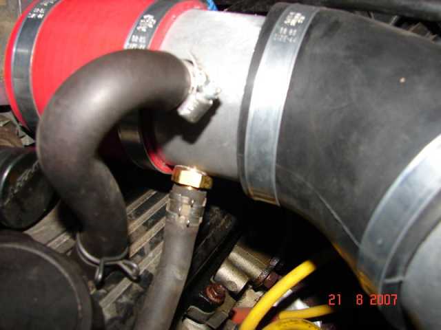

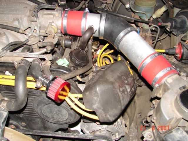

Here are some pics of my intake. There is NO vac leaks anymore.
What other suggestions you guys have on what else to check?
