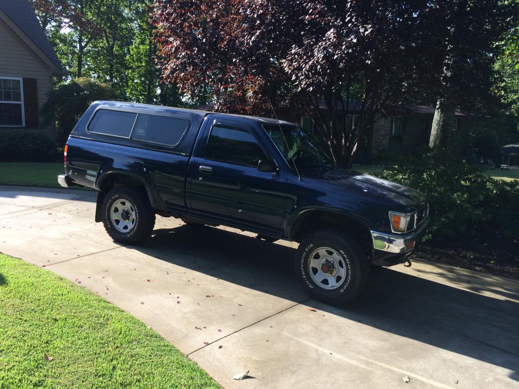

Hey fellas been lurking for a while but have always been able to find the answers I needed. But I am not having luck with this one.
I have a 1992 4x4 single cab. 22re fuel injected. The truck has 242k miles and runs like a dream unless I let it sit for a day or 2. If it sits for a day or 2 that first start I have to let it sit an idle till it warms up or else it will barely get out of its own way. It misses an bogs. It won't stall it just won't barely get moving. But all I have to do is rev it up a bit till it's warm the. She runs an drives no problem. I can let it sit all day while I am at work an jump in it no problems.
The only other issue I have had is when I put my blinker on while I am driving my speedo drops like 25mph very quickly then bounces right back up lol. And my radio an lights behind my ac switches will cut in an out. I'm sure these arnt related but I figured full disclosure is best.
