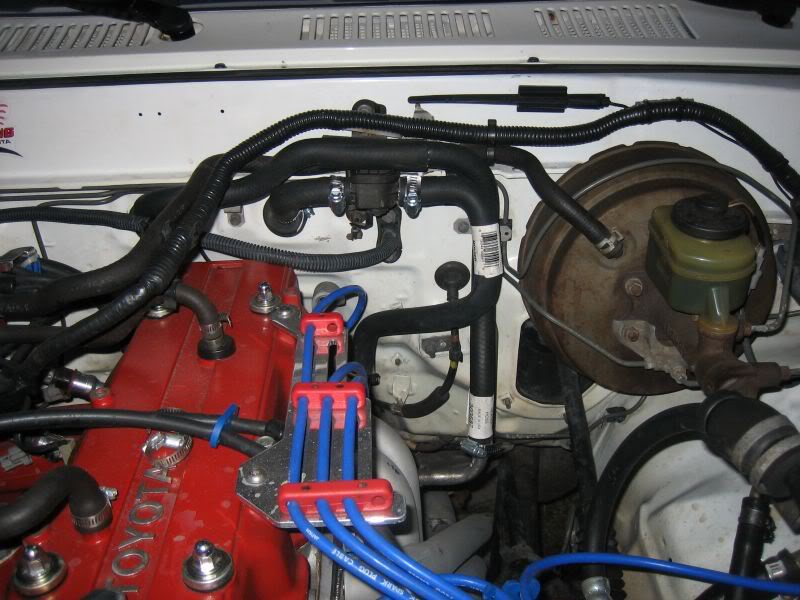

Old Oct 10, 2013 | 06:56 AM
Kiroshu's Avatar
Joined: Oct 2007
Posts: 2,747
From: NC
^-- Picture found online.

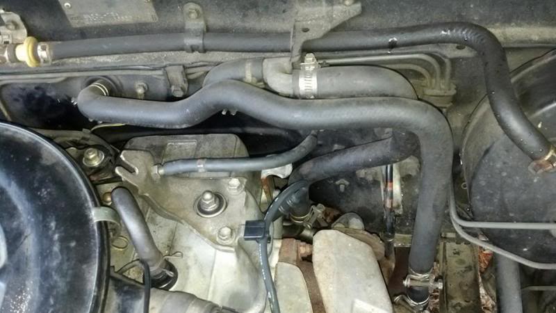

Old Oct 10, 2013 | 07:04 AM
Kiroshu's Avatar
Joined: Oct 2007
Posts: 2,747
From: NC
Picture of my 88 pick-up heater hoses.

there is a little cable that opens and closes the valve for the heater hoses. If there isn't a cable hooked up there or not moving just reach under it and manually move it. You will have heat then. the valve is top center on the pic above. It's held by that little bracket attached to the firewall.

thanks for the pictures guys, thats why im so frustrated...mine is plumbed identical to those. The valve is also hooked up and i have manually opened it by hand. After a good 15-20 minute drive rippin around gravel roads still no heat. what could be wrong under the dash? my vent/recirculate lever dosent seem to do anything, i took the dash off once and the defrost/heat/mix/ect wasnt hooked up so i manually moved the cable to where heat would be and still nothing
does that hard line that comes around the rear of the motor go up to the pass. side water pump/timing case or to about the center of the intake manifold right under the egr?
Old Oct 10, 2013 | 05:44 PM
Kiroshu's Avatar
Joined: Oct 2007
Posts: 2,747
From: NC
^--Pipe your referring too, goes to the heater control valve that is attached to the intake side of the cyldiner head.
