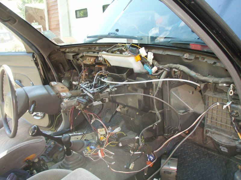

Old thread but my trucks heat was feeble at best this year so i back flushed the heater core…blistering heat returned…i was this far away from pulling the dash to replace heater core. Ive pulled a dash from my Toyota parts truck and still have that mint dash in my storage building but im in no hurry to install it
