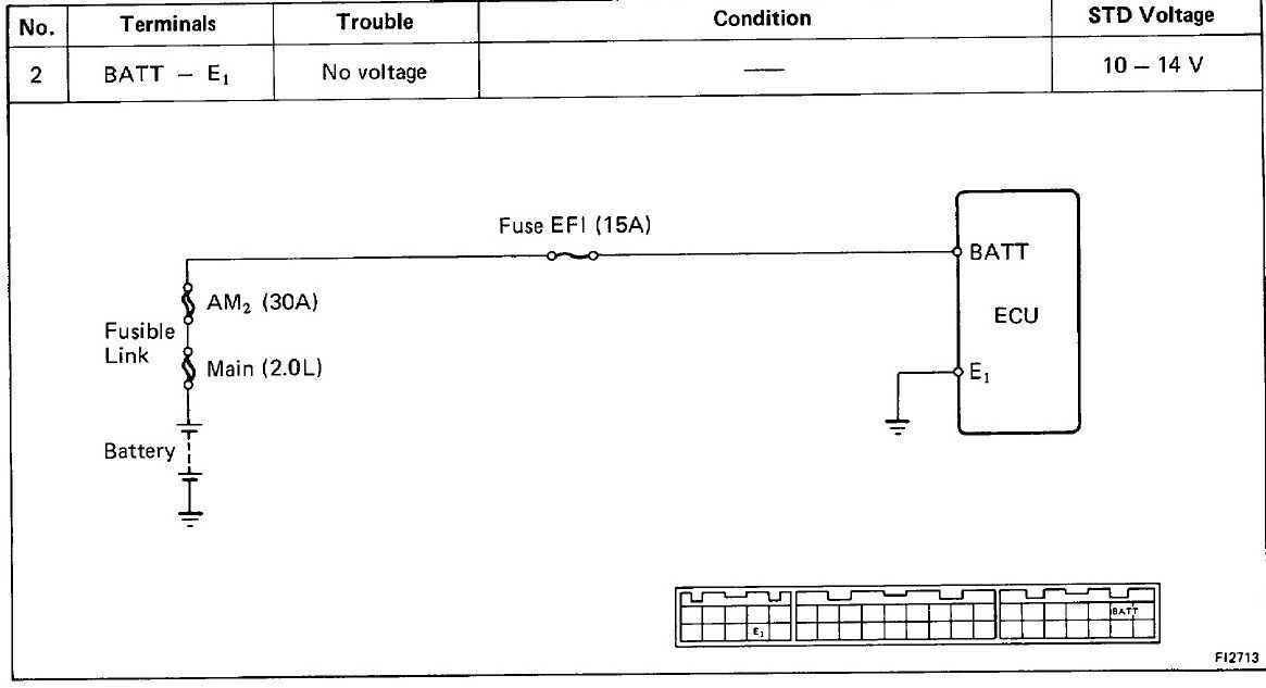

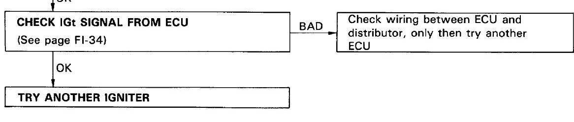

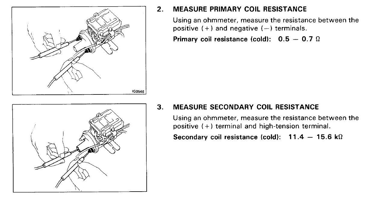

Here's the "stuff" from the FSM:
Does that all help at all?
