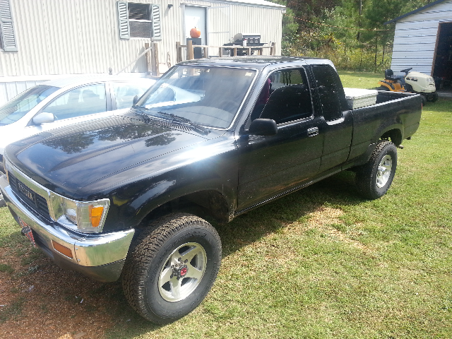

My truck brakes work great after driving for awhile but if it sits over night the next day my brakes suck the first few times being used. Anyone know whats going on? I have a 1990 4cyl auto trans 4x4 with working a/c, no lift and only running 235/75-15 at's
