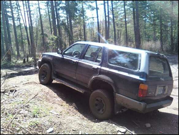

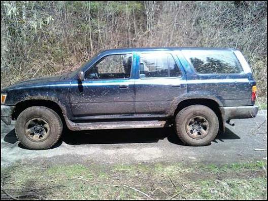

OK so I just got my first Toyota. I've had it about 3 weeks I got a sweet deal. I traded a guy on Craigslist my 92 Honda Accord that had 276,000 miles on it for this 91 4Runner. It has 216,000 on the chassis but had a new engine and trans put it 43,000 miles ago. I grew up around Toyotas in fact I learned how to drive in a 83 Toyota 4x4 in the middle of a mud pit my mom looked and me and said its time you learned how to drive...lol. I wanna start doing some mods to it so I can wheel wheres a good place to start? I was already thinking about the cruiser coils and 1.5 inch BJ spacers. I would like to go SAS but that will be a while. its my DD and I can't afford for it to be down. till I get another rig to drive. any suggestions?

I've already lost the running boards and have a friend thats going to fab up some sliders for me. and possibly some bumpers. I've takin it out a few times already but I know what you mean sdstud. learn its limits now so I can appreciate it more after upgrades. makes sense. so heres a questiond for all of you I keep seeing people talking about "cranking" their torsion bars. so whats the deal with that? if I tighten the it can raise me up a little? I understand it make it a rough ride but when I got it the guy said he "cranked" the TB to bring the front down to compensate for sag. I replaced the bad shocks and now the back is high. i'm at 11 1/2 inches from the top of the wheel to the bottom of the fender right now. and barely off the bump stops. if i hit a small bump i hit them.

you should be closer to 13" from fender lip to rim. What size tires you running?

The front should be closer to 15" from the top of the rim to the fender lip (between 14" and 15" for sure) The back end will allways be different due to the sag and the different wheel well profile (can't remember off hand what it's going to be) Cruiser coils and BJ spacers would be a good first mod, that and getting your torsion bars set close to stock. What gearing/transmission do you have? This info may dictate the order in which you do mods!

Bringing it up to stock height and BJ spacers/cruiser coils would give it a comfortable ride and the height to fit a good selection of tires. It's sad how those 235's fill the wheelwell, you definately need to get that back to stock height!
