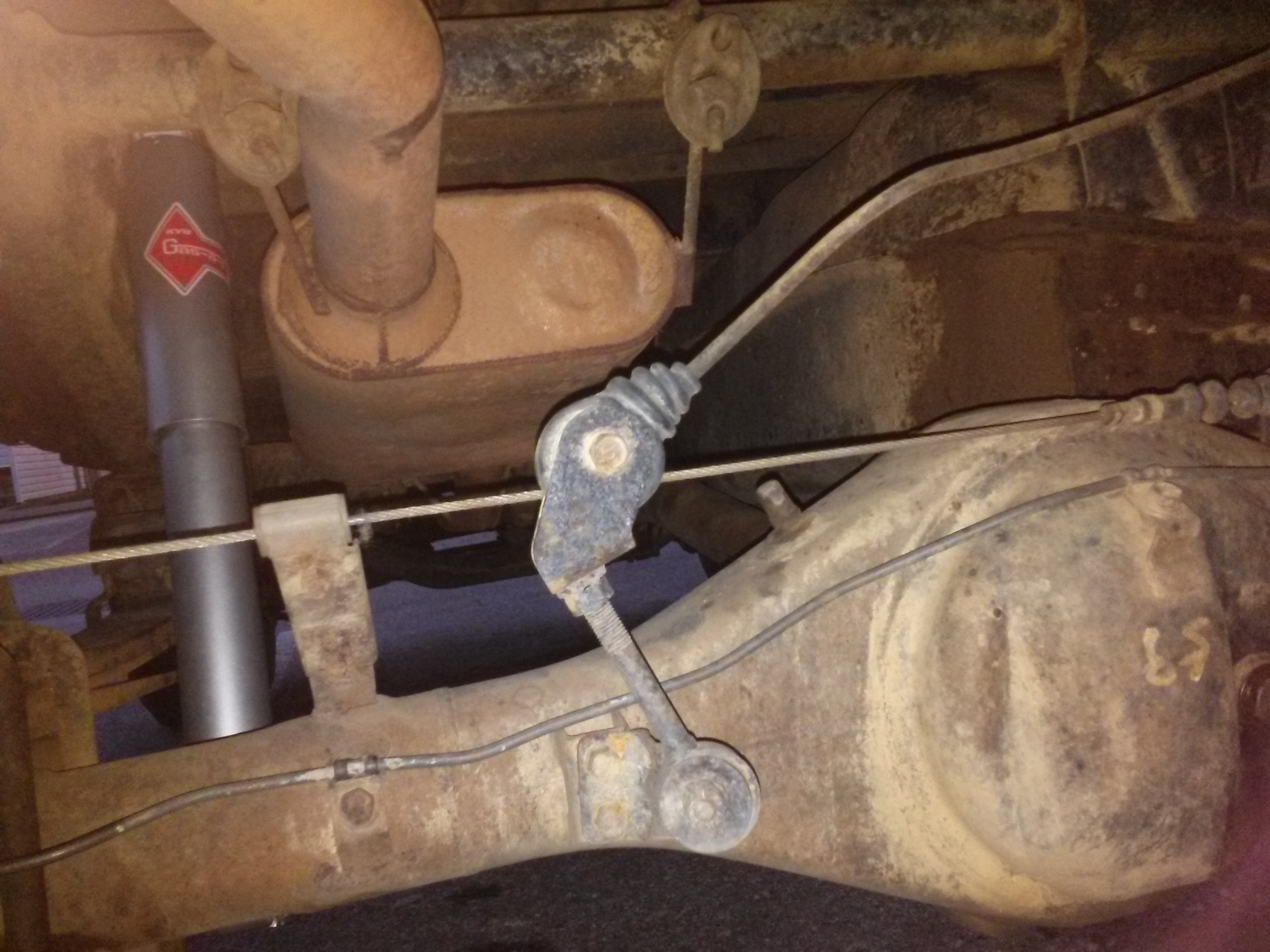

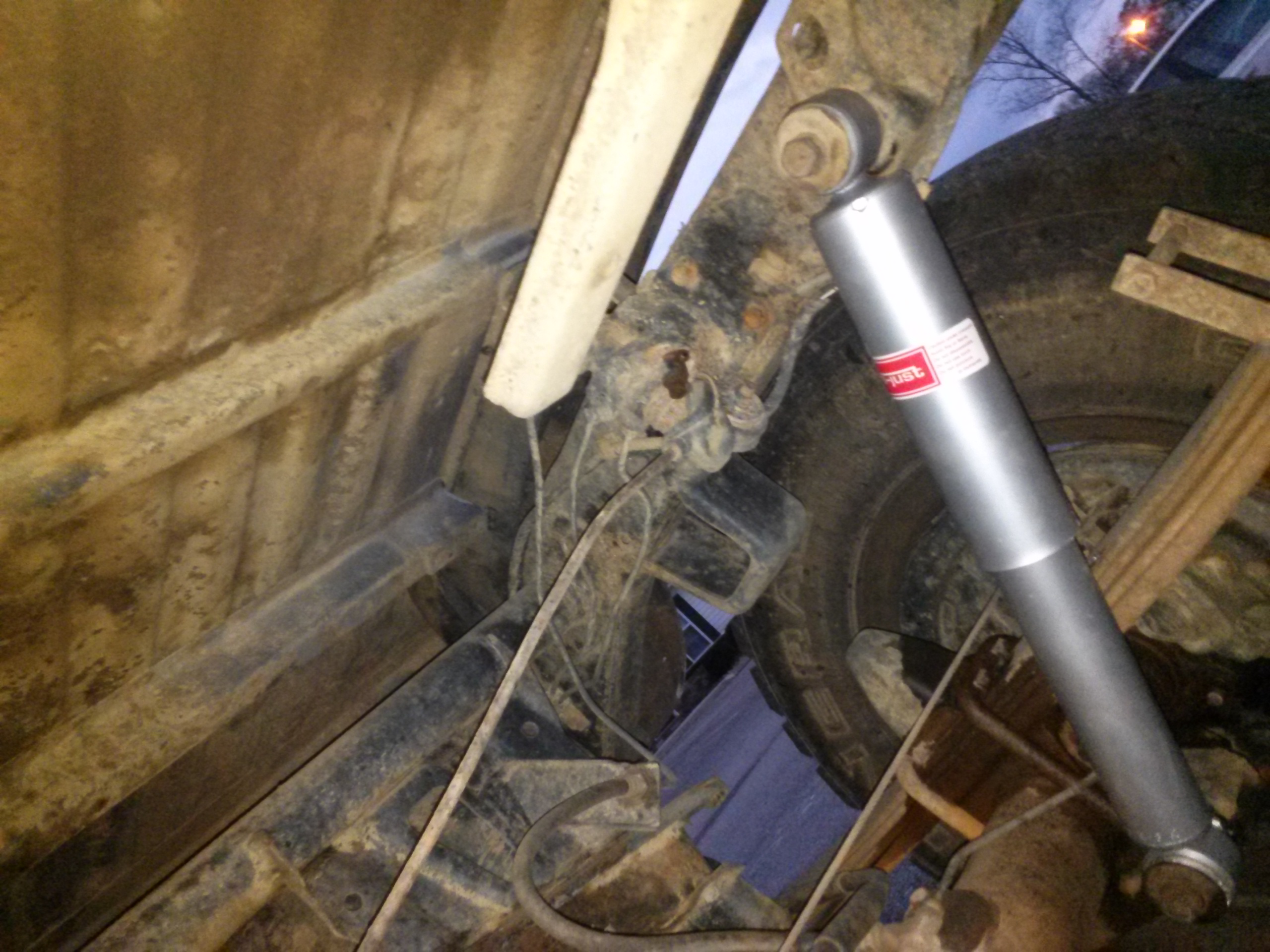

ok i got several questions hope it ok to posts them here...first i bought this truck last month 1986 22r carb. its got 150k+ miles showng but recently had the motor completely gone through less than 1k miles on it...it has a 2-3" inch body lift.. im thinking 2" has 31x50 tires..

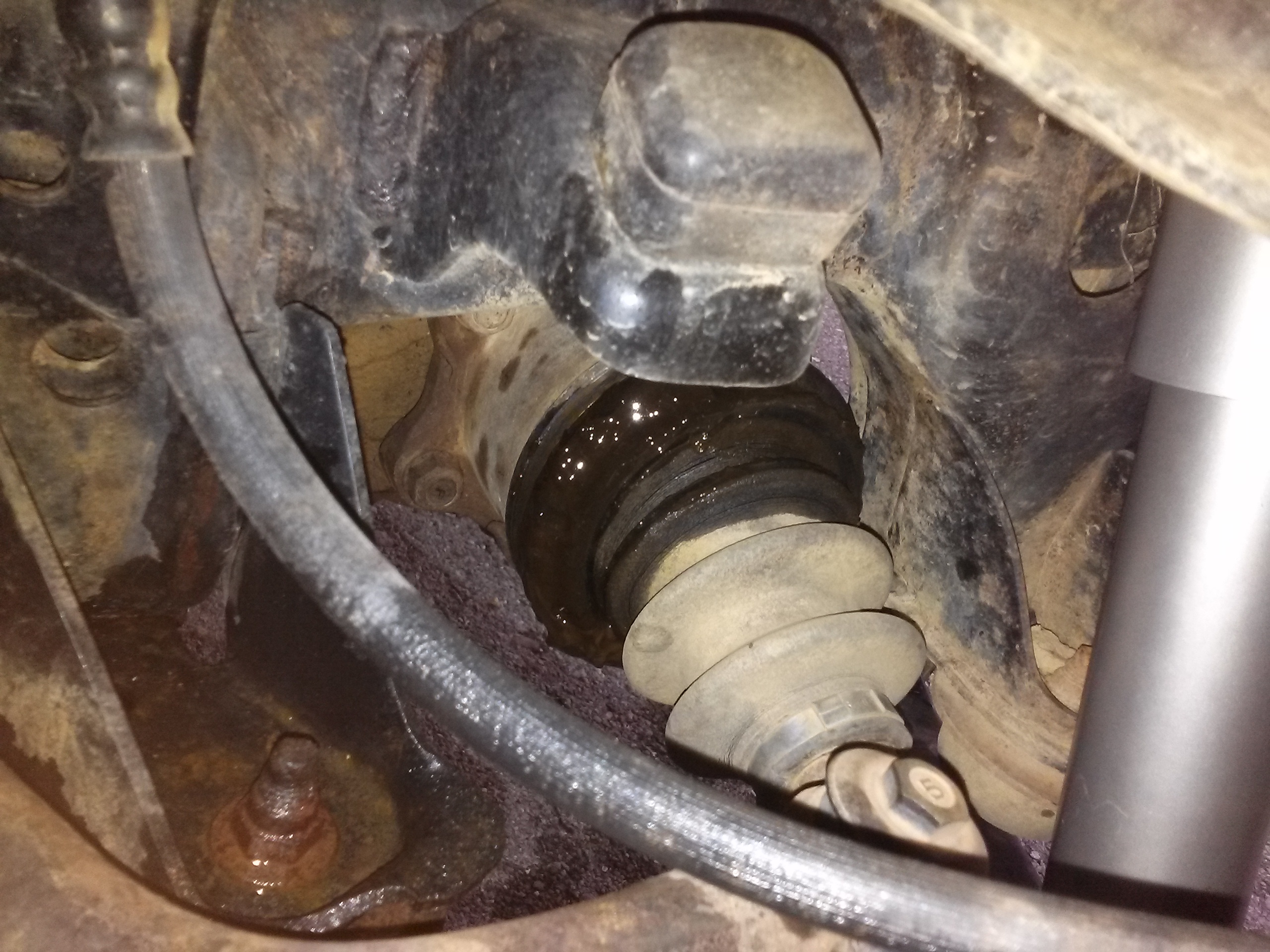

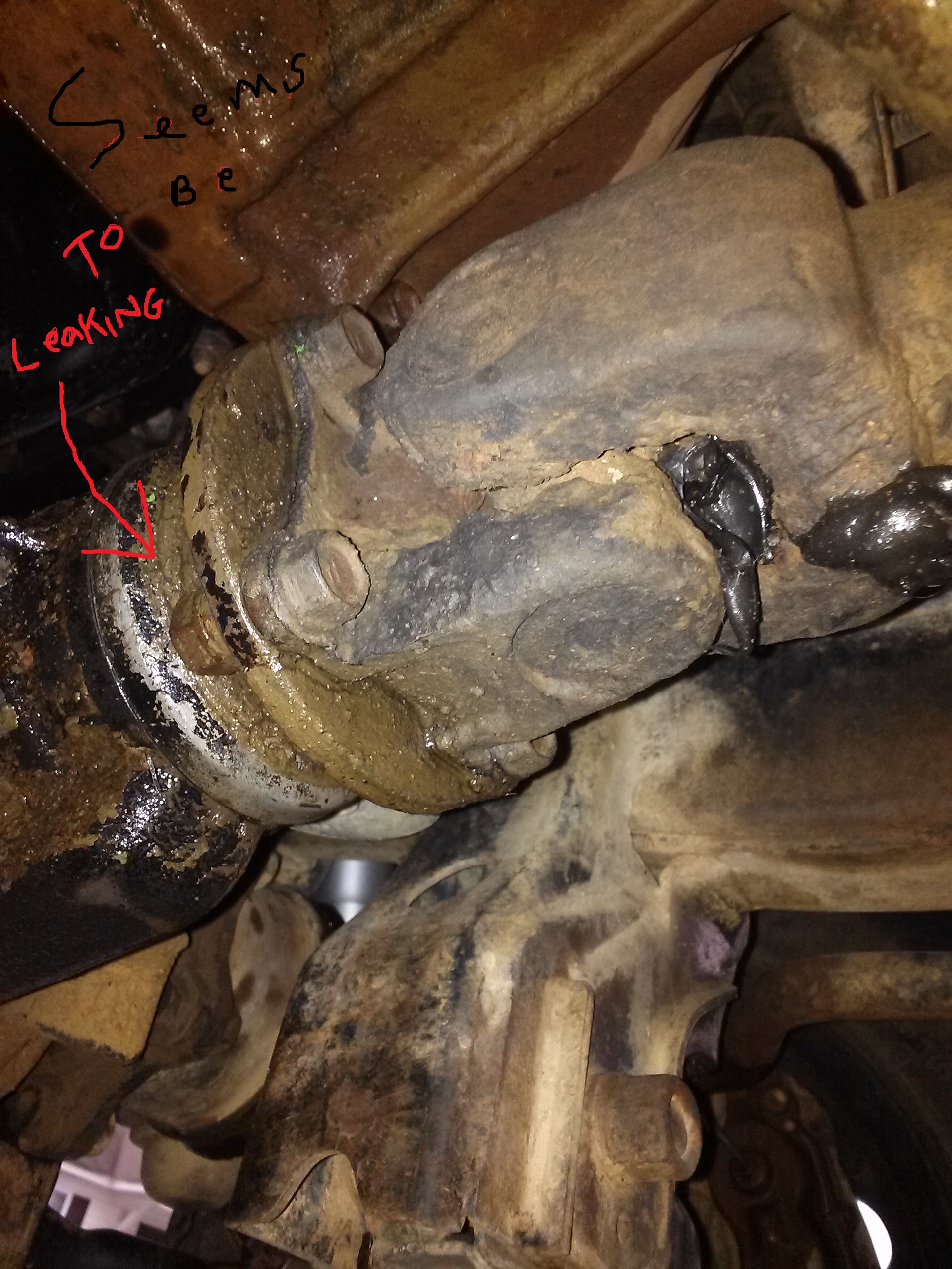

i took the truck to mechanic to replace the rear pass. axle seal..and when i went to pick it up i almost rear-ended a lady, i had little to no brkes..i took it back thinking he needed to do a better job bleeding but he assured me that he has been doing this type work for years and NO air got into the system..after bleeding they are as bad as ever..i wanna believe the guy but like i told him he needs to believe me as well, i had brakes when i dropped it off. ..so he said he thinks its the master cylinder .i dunno maybe hes right i bled brakes again after i got home being sure to bleed the lspv..still no brakes..i can stop if i pump a few times before applying but just standing on them does little to stop....so i guess i will replace the MC ..but i did notice while under there that the arm thing coming from lspv was attache to axle. being as it has a body lift should i unhook and tie it under the bed as far as possible or should i leave it alone and just replace the mc..will it help braking? also i put new shocks on it today and noticed some leaks one from pass side cv joint boot. can i just replace boot or might it be something more? also the front propeller shaft? not sure if thats what its called but its leaking as well. is this relatively easy fix or should i leave it to a mech? i will try to add pics..oh and one more ive been trying to find the plastic cosmetic things that go beside doors ..and near rear fenders theres a small plastic piece as well..i have had zero luck finding those anyone know what they are called and where they can be purchased?

heres a pic of pass. front axle boot leaking like crazy!~
also my truck is 1986 i thought those had a solid front axle...??

He probably loosened the rear brake adjustment so he could remove the drum to replace the axle seal. I would suspect he forgot to readjust the rear brakes when he put it back together, and they are now not adjusted anywhere near tight enough. In that situation, the rear brakes consume almost all of the fluid from the master cylinder just to move the shoes into contact with the drum, leaving little fluid pressure for actual braking.
Go back and tell him to properly adjust the rear brakes.
Does your e-brake work at all? I suspect not.

i unbolted the lspv arm from axle and lifted it as high as it would go and tied it off..didnt help!!!
guess tomorrow i will take tire off and see about adjusting brakes..ive never fooled with rear brakes before.. is any special tool required?
ok i just kinda found out how to adjust.. can i adjust on my truck without removing the wheel? how tight should they be? maybe one revolution free spin...is that sound about right with the lspc arm tied up? just not sure if i should leave it up or put it back down...
