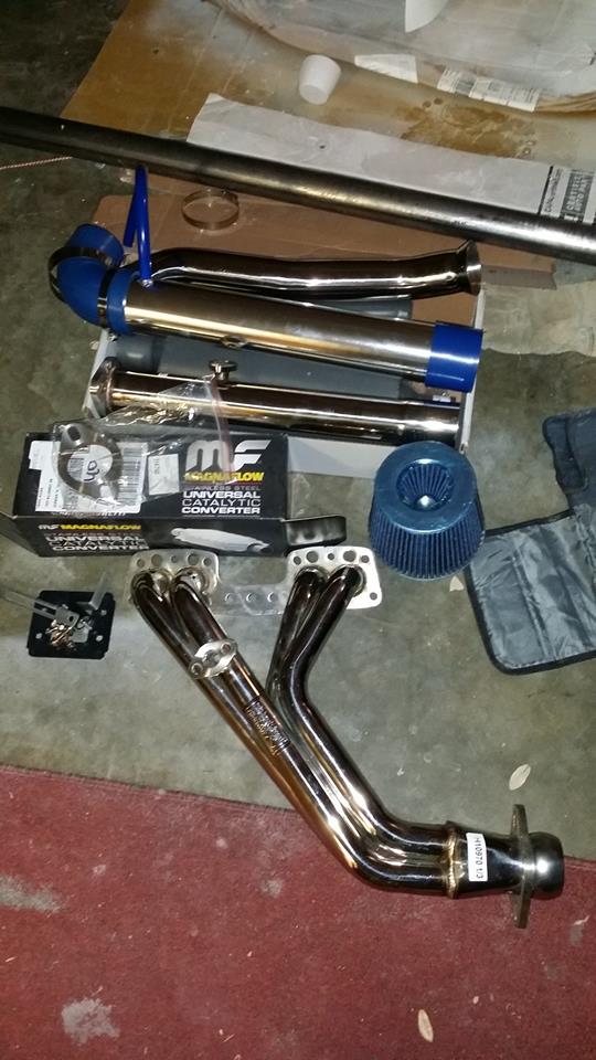

I just can't wait to put my truck back together, I got hit twice in two days at the beginning of the month and it gave me the leverage with the old lady to fix all the things I've wanted to; getting new exhaust system from the headers back, new intake, entirely new front end from the radiator fan out (idiot made a left turn into the front of my truck after cutting off a bus - the other idiot managed to hit me while turning out of a parking spot and got his tundra stuck on my bed.) new brakes, obviously the clutch/flywheel/etc.
Luckily the payout from both insurance companies is covering most of what I'm doing. I just want to see how she drives after all that work. Since I've had it the clutch has been pretty damn tired and the exhaust was terrible. As soon as I get the transmission back in I'm throwing on an OBX header, magnaflow cat, summit two chamber muffler and a custom bent 2.25" pipe to the rear. (It'll be 2.25" from the collector through to the back) and a 3" short ram intake. The engine was rebuilt a few years back (only around 3-5k miles put on it since) and that included shaving the head and boring it 20 over. So I figure the engine may perk up a bit with some extra breathing. I'm not expecting it to be a race car or anything but the waiting is still killing me
Attached Thumbnails New member, goofed on pilot bearing-10671297_625932354178976_2970616056441533806_n.jpg
