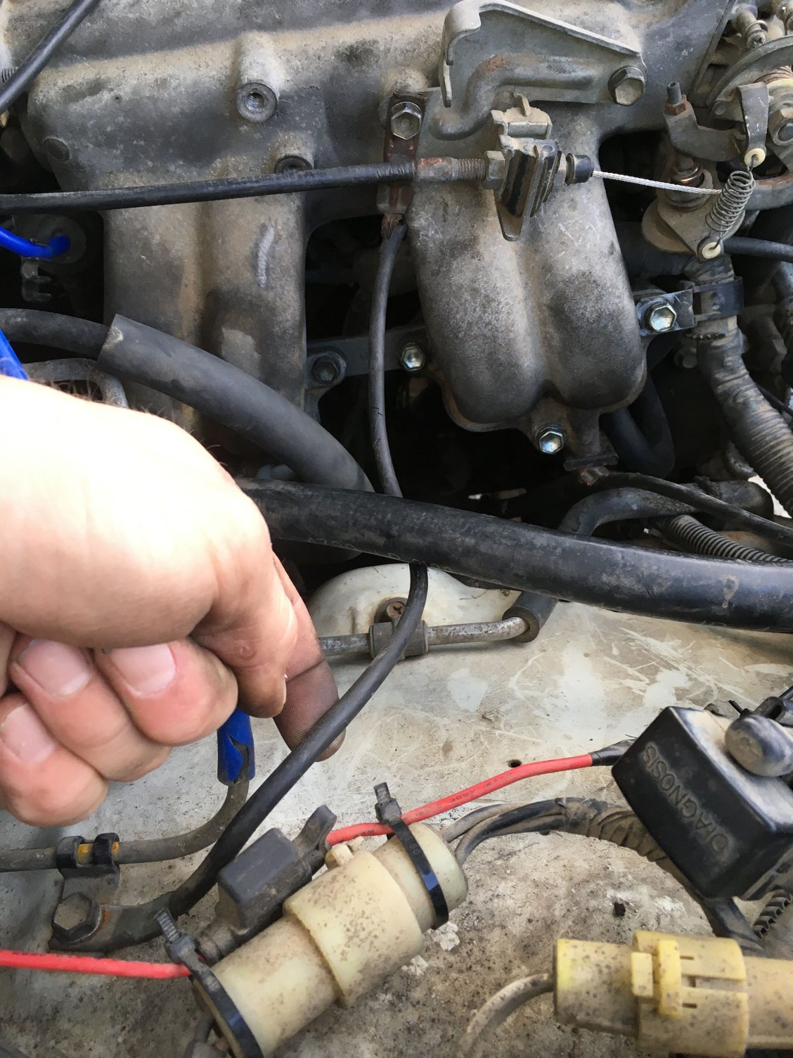

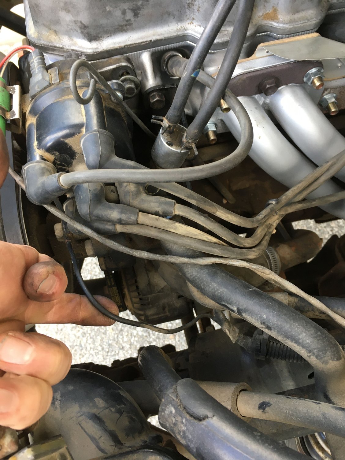

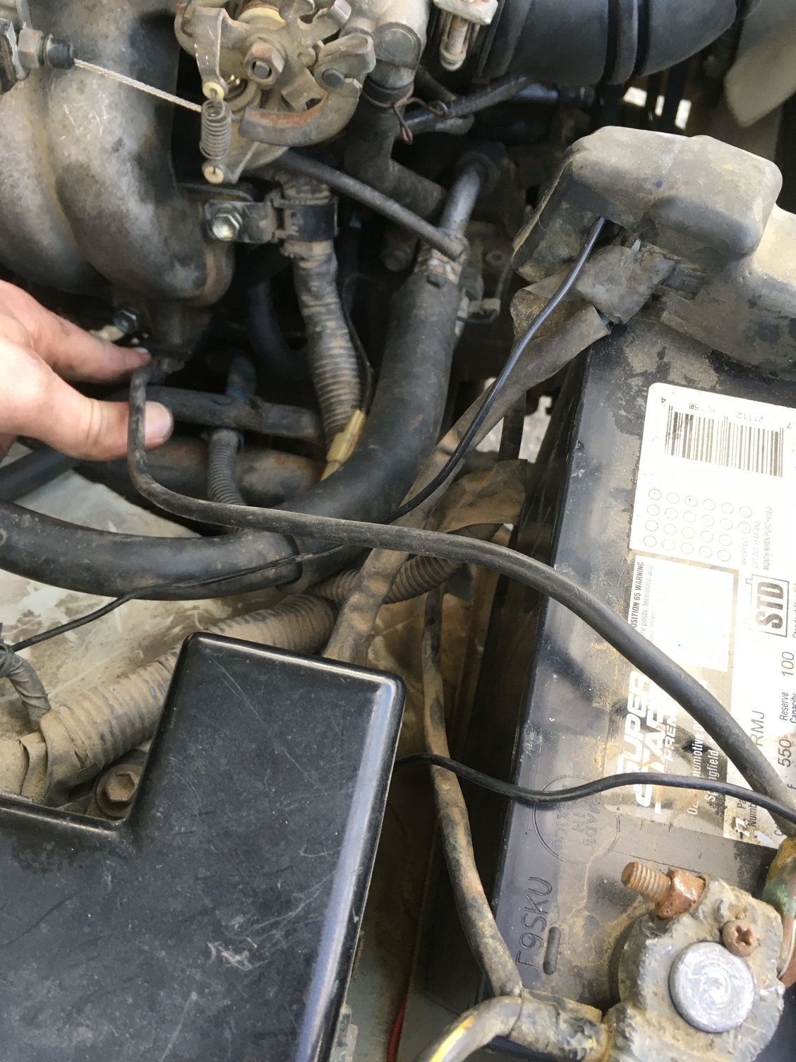

1st pic, redundant, also grotty, and not listed in either of my Toyota electrical manuals.
​​​​​2nd pic, redundant.
3rd pic, also redundant
(All three of these are redundant to the last picture. Multipath grounds aren't needed nor helpful, setups like this cause a phenomena called ground bounce which is essentially an RF noise which is bad for things like radio broadcasting and computers. The proper way to do it is what's called a "star ground", which essentially means one end of all the grounds come back to a central location.)
.. But I digress
4th pic, close but not where it goes. (The wire remembers where it wants to be, look at the bends in it, it wants to be behind the distributor under the top rear bolt of the power steering pump bracket. This bolt has an extra flat washer on it the others don't and isn't fully painted. It will work there where you have it if you cleaned off the paint both where you attached it and off the back side of the brack where it contacts the block. This is the reference ground for your alternator..)
5th and last picture, this is your engine ground it provides high current ground for everything attached to the engine as well as the efi computer. It's close enough to where the factory put it but looks really dirty and routed under tension, ID suggest cleaning it up and routing it above the AC line.
Is any of that related to your not being able to throttle up the engine? Maybe not, but clean grounds aren't going to hurt it any, and that fourth ground isn't helping most likely.
