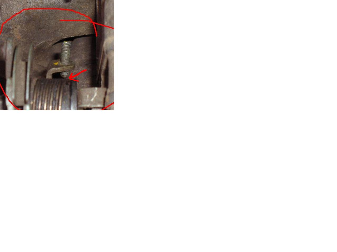

Before i posted i had the screw thats on the throttle back far enough so that it is not touching the dashpot(adjusted.jpeg) so right now the dashpot is not touching the throttle at all, it is just sitting there doing nothing. Now the only thing that has changed from before i put the dashpot on to now is the fact taht the throttle assembly was taken off(take of the nut with the arrow pointing to it and it just slides off and slides back on) now im pretty sure that can only go on one way and from what happened today it seems to be that it is on right. This morning the throttle was high (around 1500rpm) when warm like it has been for a week, dashpot still not touching throttle, but tonight when i got home it was down around 1000rpm and purred like a kitten. Now sometimes it does go down that low but as soon as you touch the gas it goes up and comes back down to idle at 1500 but tonight it was alright. So question #1 is what is up with the above scenario and question 2 is i havent adjusted the idle screw in about a year and all along before i even had a dashpot it was idling around 900rpm where i wanted it, but now that i think about it i dont think the idle screw should be out all the way just to get it to go down to 900 should it?

Hummm. Well, personally I never mess with the nut you removed unless I absoluetly have to. It's easier to remove the entire throttle as an assembly. It's too easy to screw up the spring tension. When you removed the assembly, did the spring un-coil on you at all?
The other thing that can happen is that you can mess up the torque, which essentially allows the plate (the butterfly) to have too much tension, and allow poor movement of the plate in the bore. Look down the bore of the throttle and see if the plate is rubbing against the bore. In fact, check this anyway, cause this could be your problem in itself. Check for carbon build up too, which can also cause the plate to bind. If so, take some carb cleaner and get this out. The plate should be able to move freely and should snap full closed (except MAR) and do so quickly.
Also, does the dashpot have a vacuum on it? If so, you need to check the source.
Check these couple things and post back. Handle the throttle and idle problem first, then address the dashpot problem.

yeah i never thought about the whole tightening the nut to tight deal. But no the spring did not uncoil as far as i noticed if it did it only did a bit. It's to late for me to check tonight but i will check tommorow, but if it doesnt create the symptoms then either my problem fixed itself, well maybe not it still idles at a little above 1000 with the idle screw adjusted totally ou, or its some weird thing that comes and goes. And no my dashpot is just a spring, no vacuum. Thats what i was trying to do is fix the throttle problem first, the dashpot is only cosmetic but with a 5spd i find it makes stop and go traffic a lot smoother. tommorow i will go out and tinker with it to see what happens, thx
