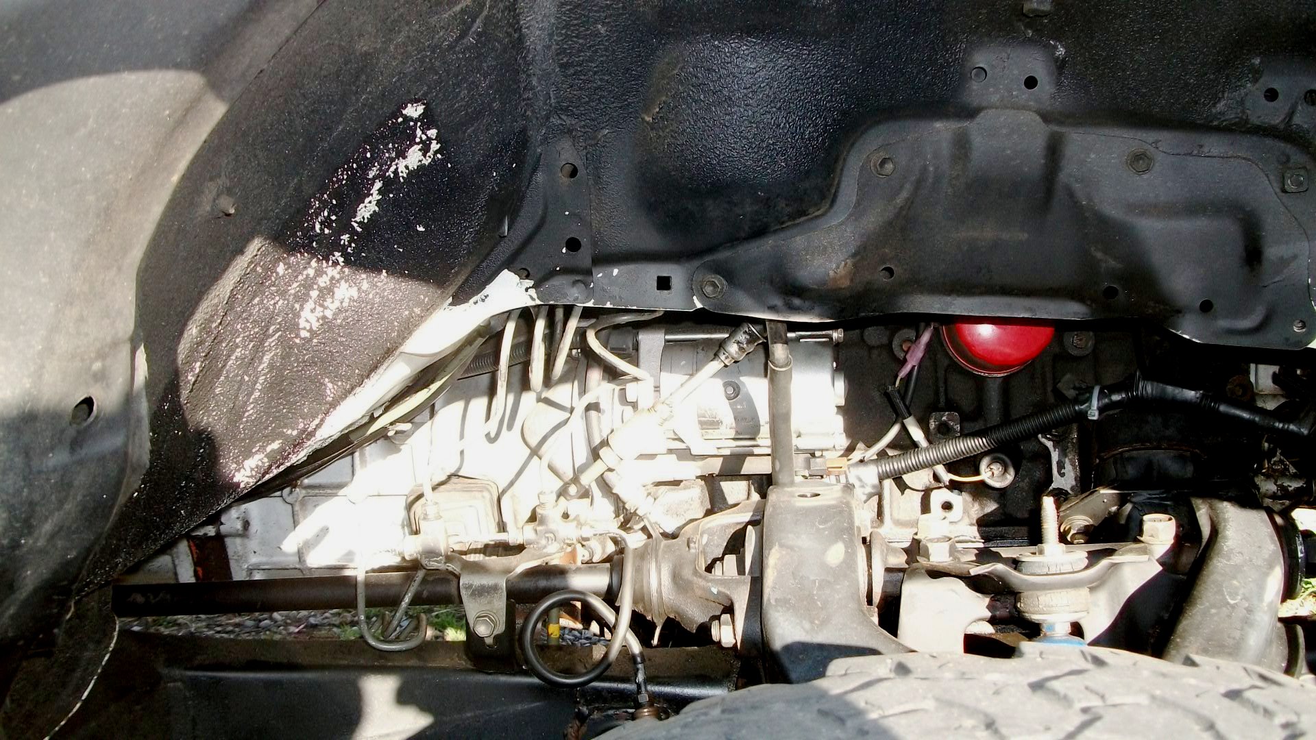

Old Jun 15, 2015 | 09:07 AM
shadowbirdie's Avatar
Joined: Mar 2015
Posts: 159
From: Nampa, Idaho
The fuel filter was a particular pain, but easy when you're tearing the whole thing d
And order of assembly sucked, put the filter on the bracket upside down and then before the cooling line to the heater, @#@*&%@!!!!
And no I didn't look at the arrow on the filter, woulda, coulda, and shoulda..
My first time, won't be making that mistake again..
As far as the oil filter, can't figure out what the problem is?
It's there in the picture, reach in and grab it..
Having a 3 inch BL and 235x10.5's, I'd have to get on a step ladder to get in from the front, going in over the RF wheel is simple straight access, unless overtightened.
Gasket touch plus 3/4th turn only.
I have had to stab a couple with a screwdriver before, what a mess!!
