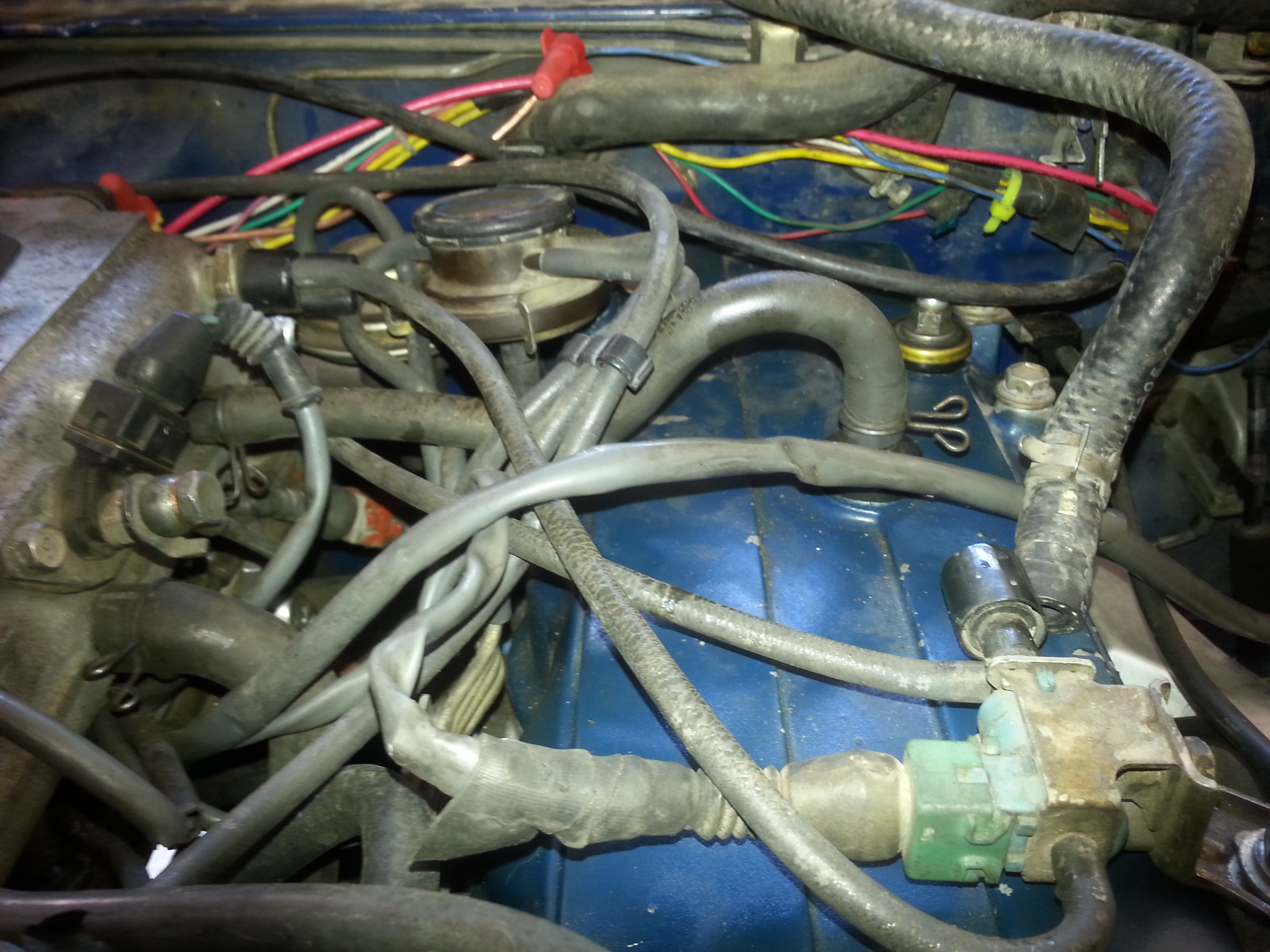

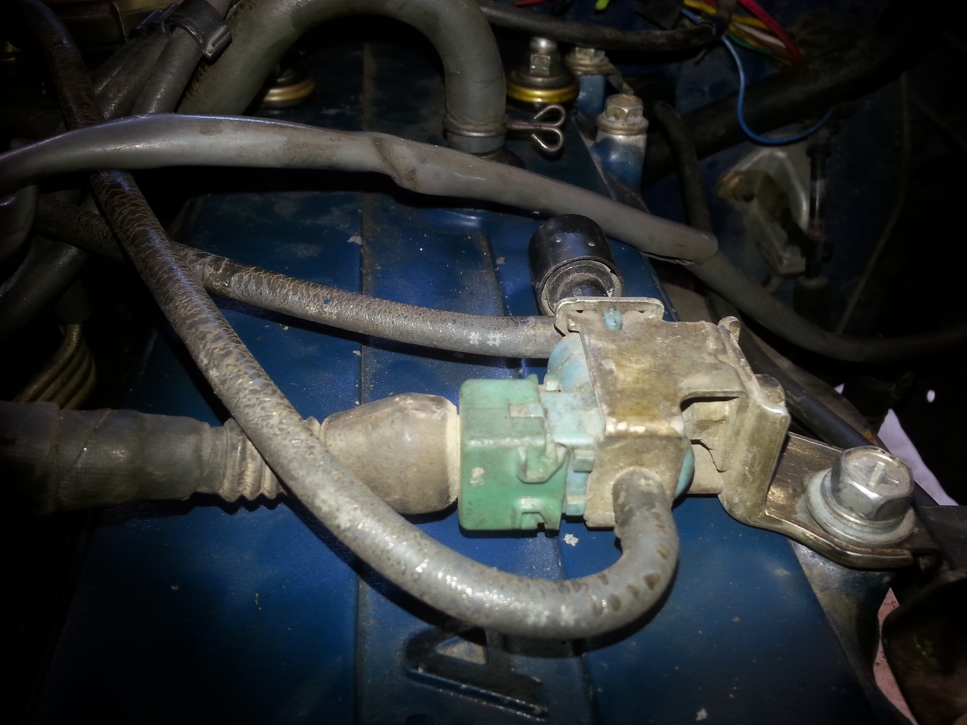

Hi new to the forum and to owning a toyota, Just did a rebuild on my 86 runner, and im having problems with power issues, i may have done the timing wrong, so that would be my first question, its a 22re, 5 speed. i dont know if i need to bridge anything or plug or unplug any vacuum lines., the manual didnt describe it very well. its set to 5 BTDC, as stated in the manual. second would be vacuum lines, every diagram ive seen shows a slightly different setup than was on my motor before the rebuild, so im at a bit of a loss. attatched are some pics of the lines and such, if you see anything that stands out please let me know, its the only vehicle that i have and i need to get it smoged so i can work lol ok its not letting me upload so i supose just help with the timing for now

Code 11 is sometimes nothing to worry about. It can mean there is no signal from the distributor which often happens when checking codes. It can also be set simply by putting the timing in by-pass to set base timing. I'd concentrate on vacuum leaks and other normal things that happen when you r&r the engine. Like broken wires or connectors unplugged. Keep it simple first. Good hunting.
