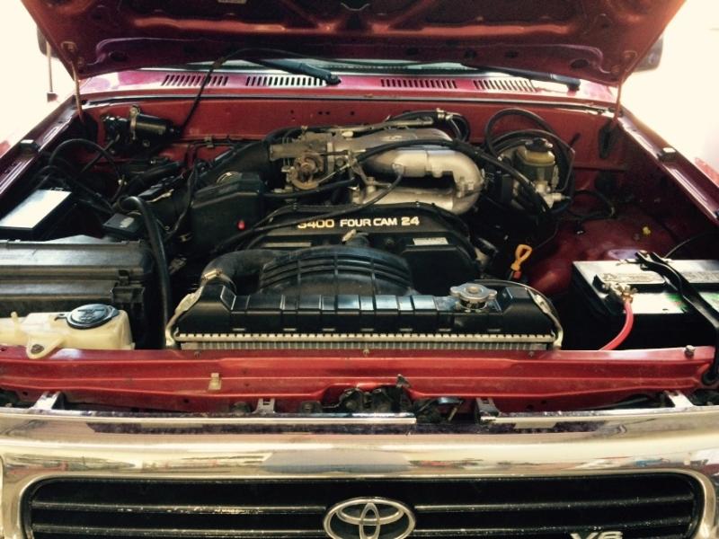

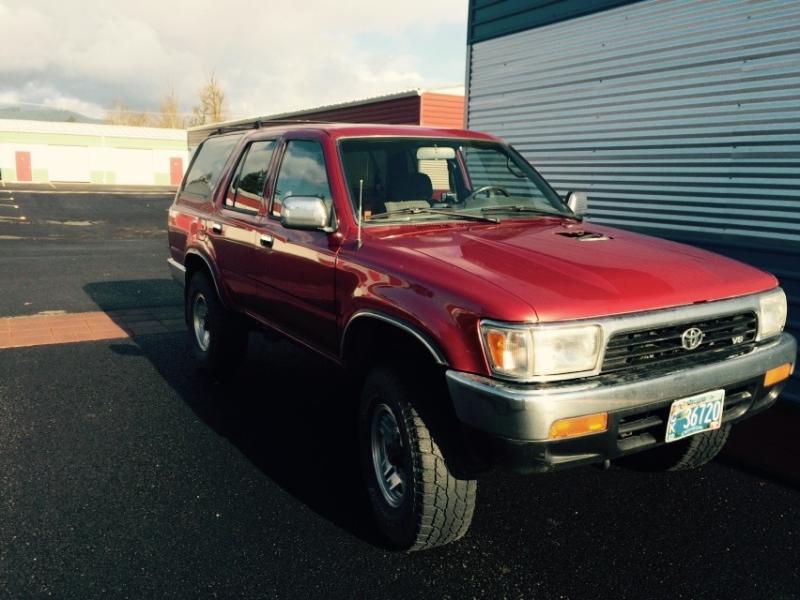

Glad you got it figured out! Lets see some pics of your rig and 3.4 swap
Nothing terribly exciting. Just a stock 4Runner besides the 3.4
It's just mostly a daily that we can have some fun in the snow and on the dunes with. It also tows my autocross car
4x4-runner
