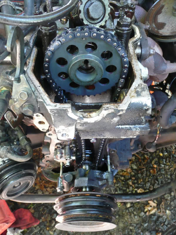

Chain wore a hole through the timing cover on my 85 celica so I'm changing out the chain and gears in addition to steel backed guide and cover. My new chain has 1 shiny link then 2 shiny links. I put the crank gear dimple between the 2 shiny links and the cam gear dimple on the single shiny link. At TDC the crank lines up with the 0 marking on the oil pump and the dowel pin on the cam gear looks to be 12 oclock however the dimple is slightly off to the left toward 11 oclock. Just wanted to make sure this was right.

yes...

yes...

yes...

Yes! on the chain
