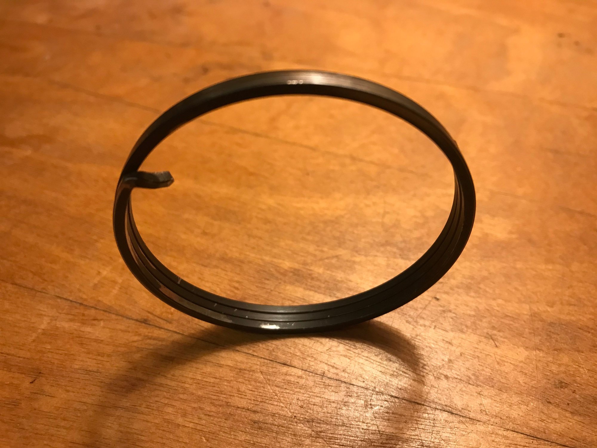

I’m looking for a spring used on 86-89 automatic locking hubs. Toyota refers to the part as a drum, and the spring is coiled inside. There should be two tangs bent at 90 degree angles at the ends. In my photo you can see one of them. The other end is missing.
if you have one and are willing to sell lmk. Thanks for reading this!

i had a thread that included the autohubs as far as they apply to wheel bearing service thread with some break-down of the auto hub components/reassembly
one of the pics shows that spring - same spring on its way to jimkola.

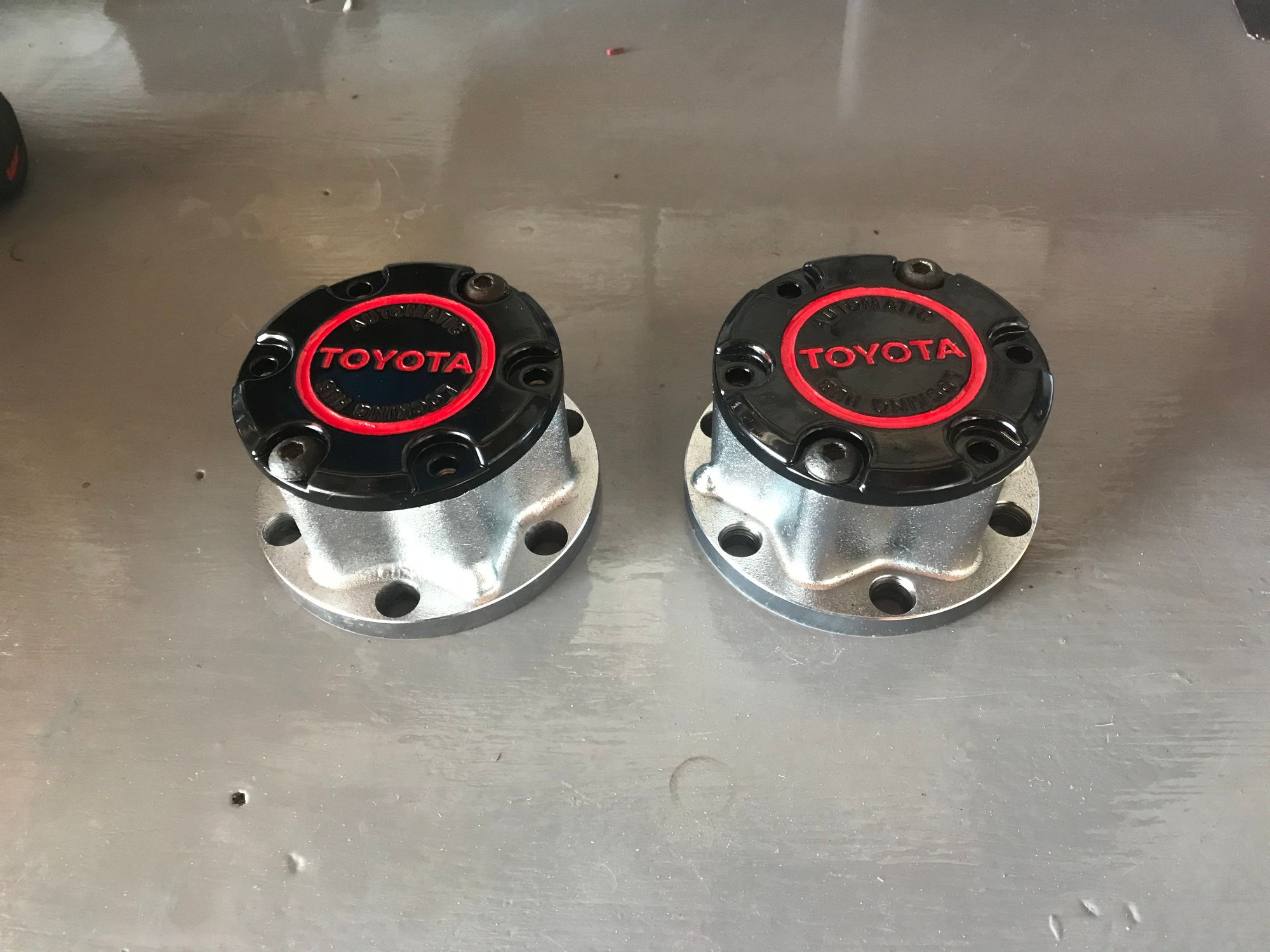

It doesn’t take much grease to hide those tangs and make them hard to see during reassembly.
Here they are now. I disassembled, cleaned, and repaired one of the outer cams. I ordered new gaskets and screw/bolts for the cap via Amayama. Got new cone washers at the same time.
I sand blasted the caps and painted with black epoxy appliance paint. The red is Testors model paint. One day I’m hoping to be able to powder coat some things.
Again, thank you to Blueman and Wallytoo😀
