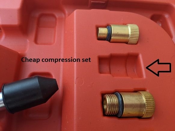

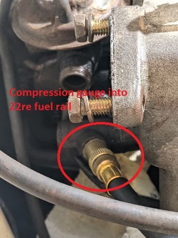

Since no fuel was coming thru the return line, I decided to take off the fuel regulator ( had to remove ERG pipe on back of plenum ) and the reg appears to be blocked as I cannot blow air thru any port, even after applying vacuum to top....
Once I had the reg off, I could see that the threads were the same as my compression gauge ( or very close) so I threaded the hose in and let the pump run for 60 seconds.
I got 700 mls or 24oz. which might be ok...but then I decided to attach my cheap compression gauge to the same line....
...and got 0 pressure....
I am pretty sure I should have gotten something ?....
I am going to take the plugs out and turn it over in case I was filling up the cylinders....

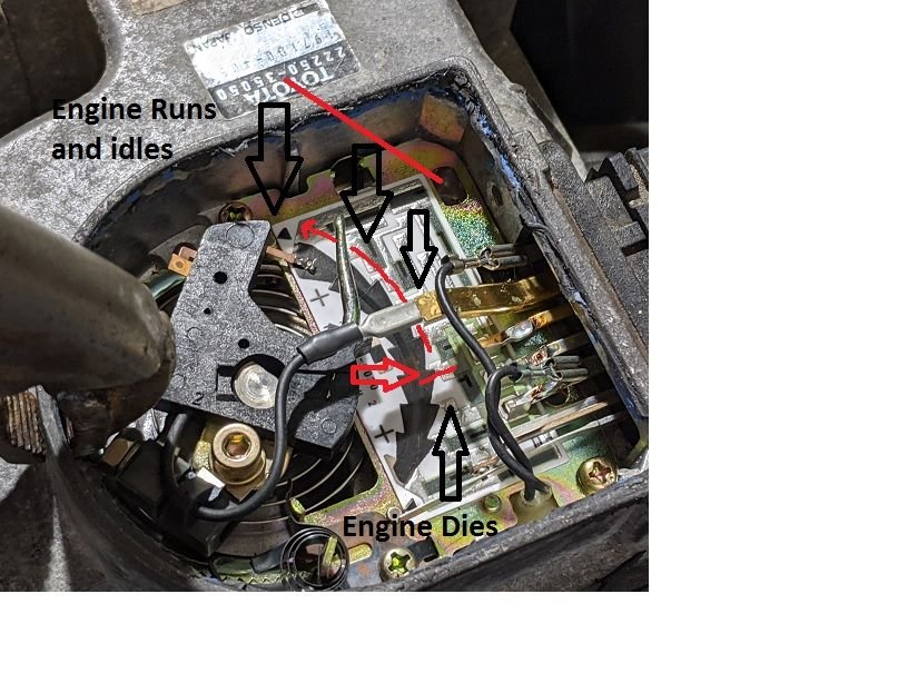

As an ongoing test, I started the engine with the AFM held completely open and the slowly moved the vane back towards 0 and fuel pump shut off position.
I could see that the engine began to falter at the third (3rd) shaped black triangle in the AFM.
I did all checks of Ohms at the AFM connector, which were correct by the FSM (an other YotaTech members)...
I also did checks of continuity of wiring between AFM plug and Computer, which did not indicate voltage loss or short....
I am wondering what exactly is happening at this 3rd black triangle shaped point in the resistance strip?...
b. what information is being passed to the computer ?
c. what other components are involved?
Thanks for any guesses....

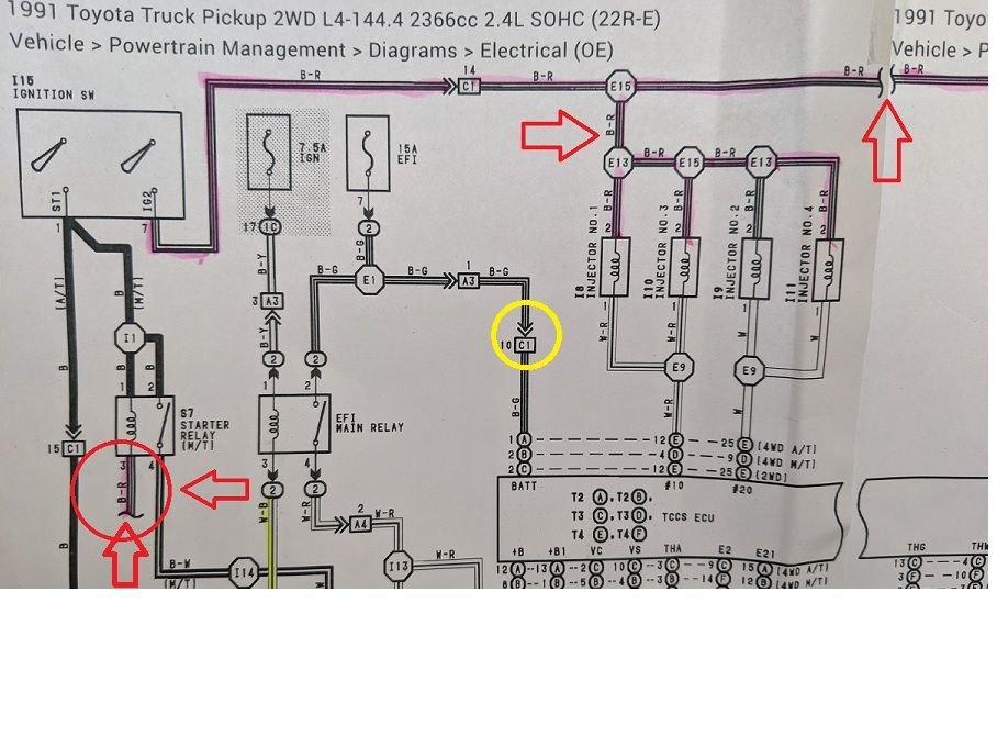

...Howdy....Can someone tell me, on the uploaded image, at the starter relay, circled in Red, where the indicated Black-Red wire goes?...
...I can see that there are Black-Red wiring to the right-top...but there are no reference #s ?...
...Also what is the yellow circled symbol indicating?
Thank you

These are pure guesses. I don't have access to that schematic. But from what I can tell, I would guess the wire circled in red, goes to ground, to allow the relay to energize.
Black-red at the top, I have no clue.
Symbol circled in yellow is a connection point. Mostly used to reference that point in the information concerning the schematic.
Is all that totally unclear?
Pat☺
Old Mar 3, 2024 | 02:05 PM
prcnctoyo's Avatar
Joined: May 2011
Posts: 236
Likes: 45
From: North Carolina
Yellow circle area with C1 in a box is a connector, the pin number for the wire is outside the box.
I can't find the symbol in the red circle in my EWD for my car (89 toyota). My guess is the B-R off the starter relay joins back up with the B-R at the top...
Ground symbol is usually three dashes stacked with long dash on top and the other two shorter in length.
Link to Toyota Electrical Symbols. http://www.autoshop101.com/forms/elec07.pdf

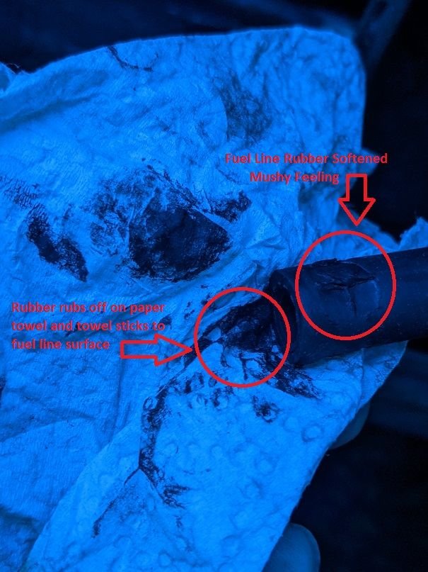

...So...after ALL of my testing I finally got around to changing the fuel pump....
...I had resisted doing so because it seemed to be functioning at certain times and I thought, since the pump was only a year old, it may have been wiring related....
...As soon as I took the pump out I could see the problem....The short piece of rubber fuel line that connects the pump to the outgoing metal line had Burst !....
...I have never witnessed this before....and I am wondering if the line supplied by the pump manufacture was bad or if something in the pump could have failed to produce such a outcome ?....
...I ask if the pump could have been the cause as the port (circled in image) appears to have a loose part....
...I am not going to trust this pump and install a new one (from a different manufacturer)....

The fact that it burst may be connected to one of your initial posts on this thread about the FPU valve not functioning. If the fpu valve is always vented to atmosphere the fuel pressure will remain maxed out which is above 40 psi (44 If I remember). When the fpu valve is switched, it gets vacuum from the plenum to raise the needle in the fp regulator which drops fuel pressure to 30ish psi ( I'm remembering 32psi). The fpu valve gets its signal during startup from ecu when ecu is getting a hot reading from coolant temp probe to prevent vapor lock during hot restart by temporarily increasing pressure. I'm sorry but I don't remember if the fpu valve is normally switched to plenum or normally open. I do know that if you remove the fpr vacuum hose from the fpu valve and stick it directly to the plenum, it will not give issues unless it's hot outside.

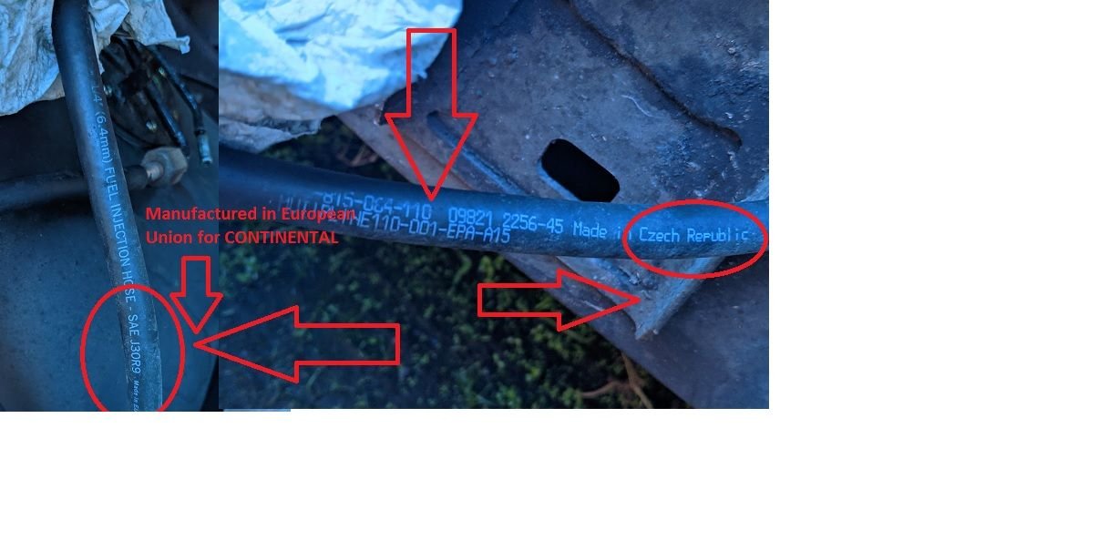

...I originally put it's failure down to Ethanol and a cheap hose provided by the manufacturer of the last fuel pump....
...but , as you point out, the VSV was not functioning ( since replaced)...
...I am just finishing the install of a new fuel pump ( I opted for one of the newer smaller ones this time and had a lot of re-wiring and mounting issues to solve) ...and I will certainly re-check the functioning of the FPU....
...While apart...I did also discover that the return line from the charcoal canister is plugged....but I'm not sure if that would be able to create extra pressure back at the pump location....
...I am pretty sure if the pump ever fails again on this truck, I am going to install an inline one ...I see there are some design now that can actually suck right thru an old pump left in place in the tank....

When I was recently replacing my fuel pump and found the short 4" piece of in tank line had ruptured, I ran some fuel thru the return line to the new pump...
Immediately I could see that the fuel was eating the R9 rated line, turning it into a black mush ....
Now, I am curious as to whether the Gas is very Bad...or is the Fuel line Not as Rated?....
