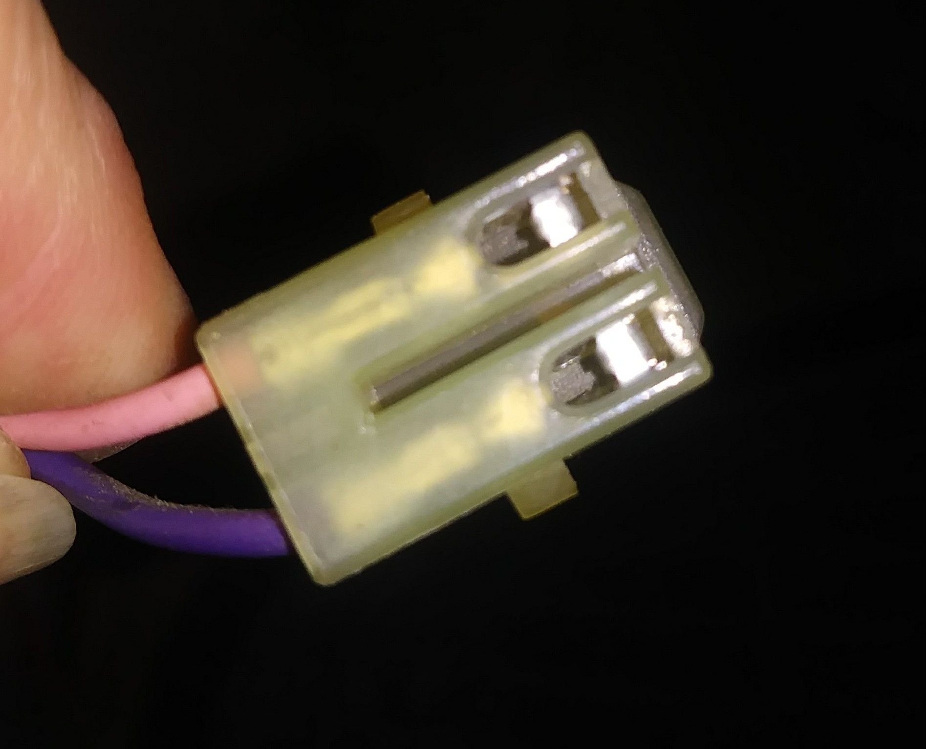

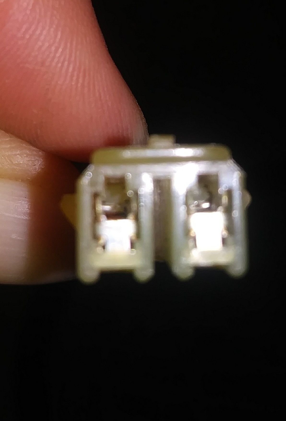

Need an ID on Speaker Wiring Plugs
If anyone can identify these plugs from my 89 4runner sr5 please let me know what I should be looking for. Im trying to get speakers finally wired up into my dash along with a head unit and It would be amazing If I could just use the factory harness since almost none of my plugs are snipped off yet. I ordered some on amazon that look like these after someone else on a forum claimed they used them but they were unfortunately the wrong plugs. Crutchfield's second option for my 4r is also incorrect as mine don't have bullet style plugs inside, just spades.
After digging around I still can't find anything that looks much like them. Anywhere I should start looking?

Are you looking for something that will plug into that connector, then you can connect the other end to the speakers you're using?

I am trying to find the plug that plugs into this yeah. I'm not trying to use oem speakers, I dont even have the ones originally in here. Someone ripped them out a long time ago.

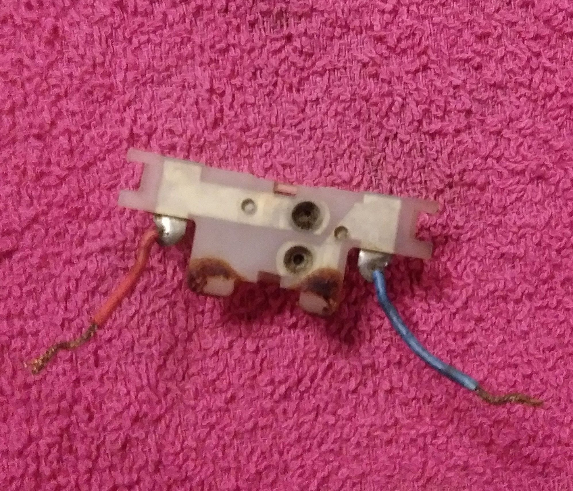

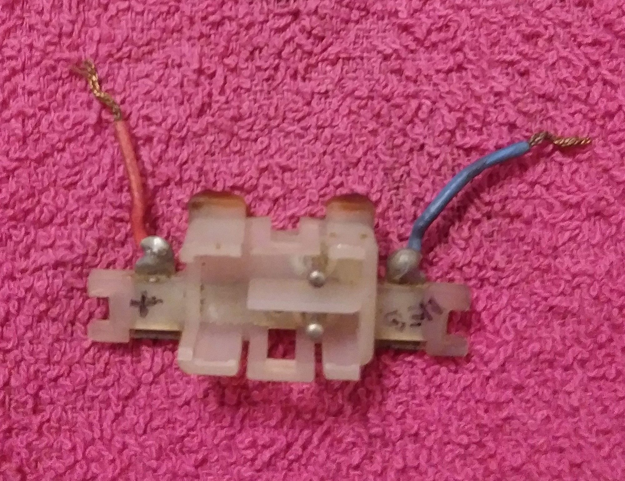

The connector in your pic looks just like what I'm using. Same purple/pink wires too. This is the speaker side connector I'm using. There is no identifying marks on it though.
That doesnt exactly look like mine, I may order some of that connector off amazon that let me do a return but mine are not bullet connectors on the harness side.

More pics...
More pics...
It all makes sense now...
My door sticker says 10/88.
If anyone has a link to adapters for these let me know. Ill keep looking for some used plugs or an adapter thank you for solving the case.

Then I guess the mystery is solved, crutchfield seems to be the only site that sells this Metra 72-8101 connector for it. Amazon and other sites have listings for them but all say discontinued or otherwise unavailable. Funny enough the rear speakers use the more common style connector.
