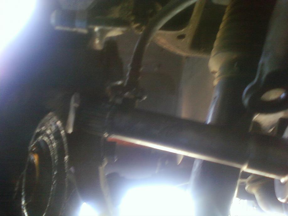

these are a few pics. You can see where im having trouble. I Removed the 4 bolts and cant get the ball joint loose.

Old Oct 4, 2009 | 03:55 PM
dutchboy's Avatar
Joined: Nov 2006
Posts: 287
From: Land Of The Lollipop Kids (Lancaster,Pa).
I wouldnt seperate the ball joint unless it's the last option. I just did my passenger side last week and my driver side a few years ago. In my driveway,by myself with hand tools and a small floor jack. Just be patient and a little wigle ehre and their. All i had unbolted was the lower shock bolt. had the rig sitting on jack stand(just the front of the truck,under the frame rails) and I worked the lower a-arm with the jack to get the position for clearance. yes...it is a PITA,but i found with patience,a few scarred knuckels and a lot of swearing...I got 'er in. Im not saying avoid disassembly of the ball joint all together. i would just save that as a last resort if all else fails. You shouldn't really have to though,but to each their own.
Good luck!

looks like you did it wrong if im seeing right and i bet im not but you put the bloted part in first where the wheel bolts on the spindle then you work the side with the 6 holes in so it all blots together i did mine when i rebilt my motor took me 20 minutes in and out not bad of a job just makes it really easy with a 48in pry bar!! lol

So i'm trying to slide the spindle side in first then the 6 bolt part
thats what the pics shows.
so what i did was separated the cv, and put the spindle part in first and then going to join the rest of it..but now i cant get the freaking lower ball joint in..
i called it a night..so i will try again tomorrow morning.
Thanks
