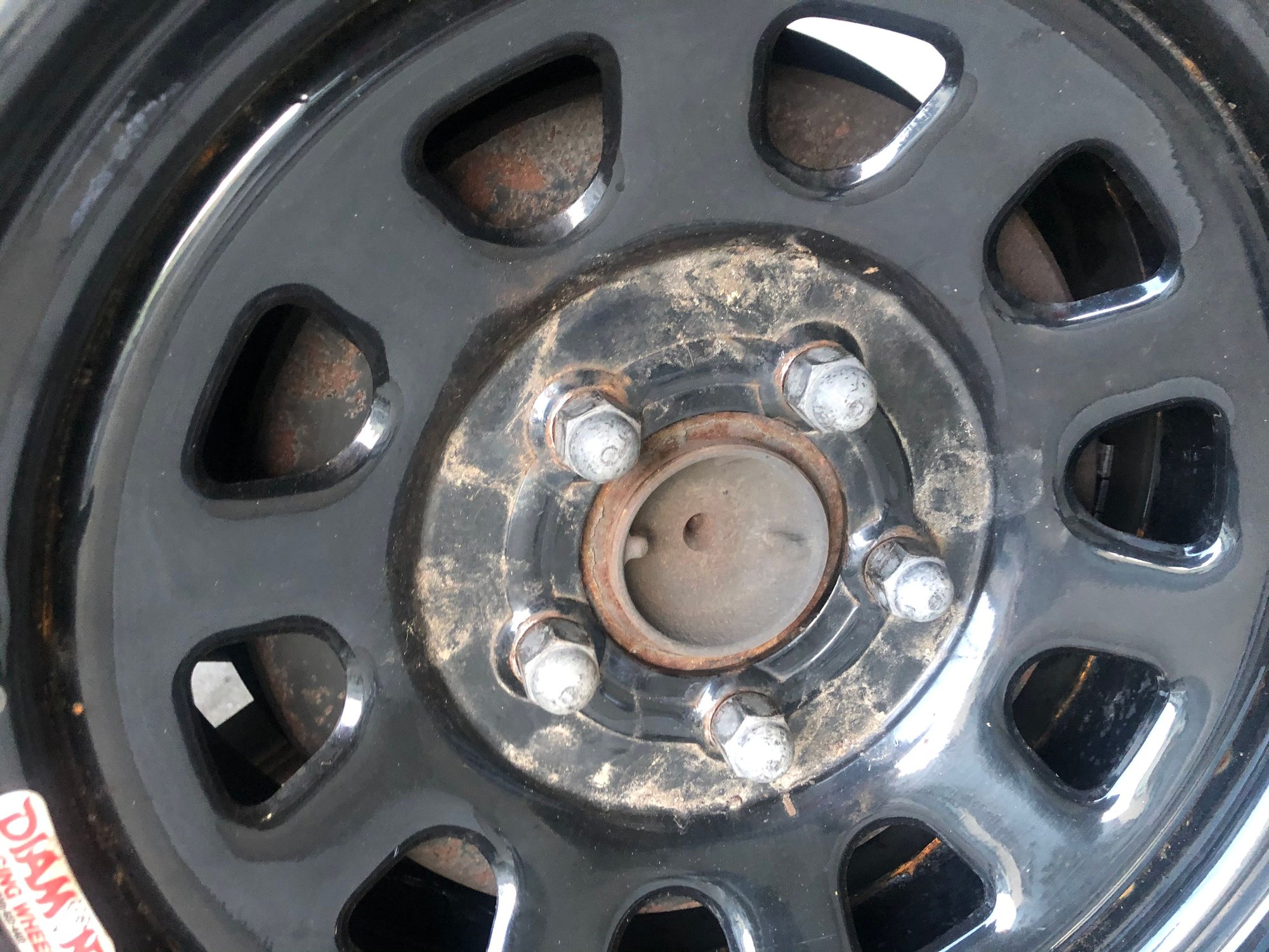

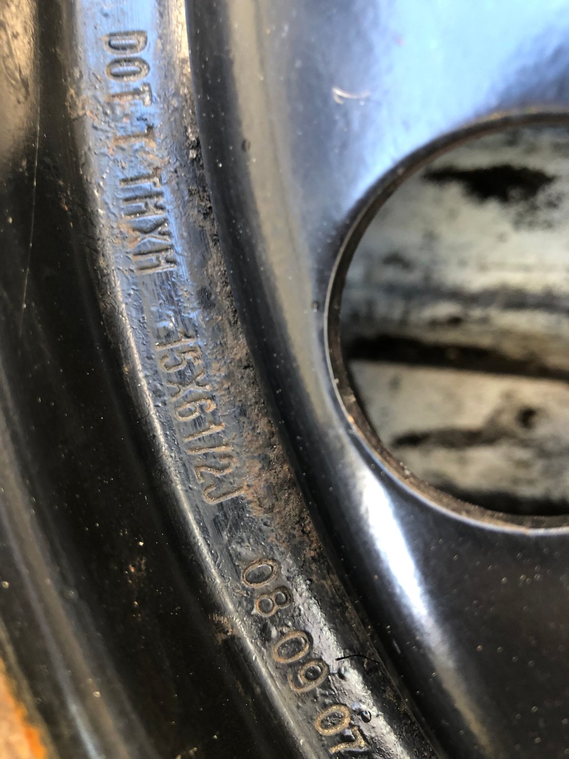

This is the honda CRV rim
Numbers On The CRV Rim

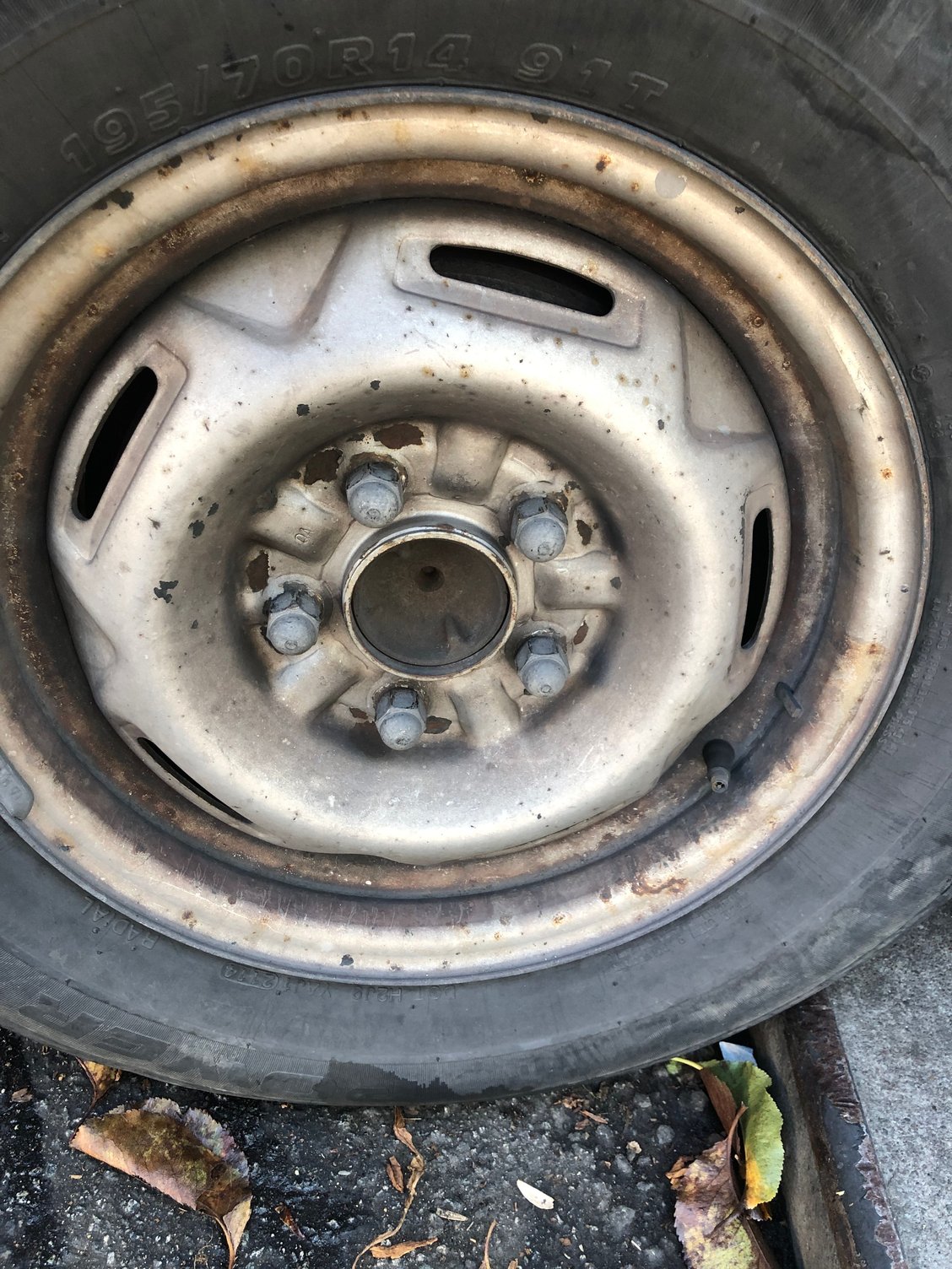

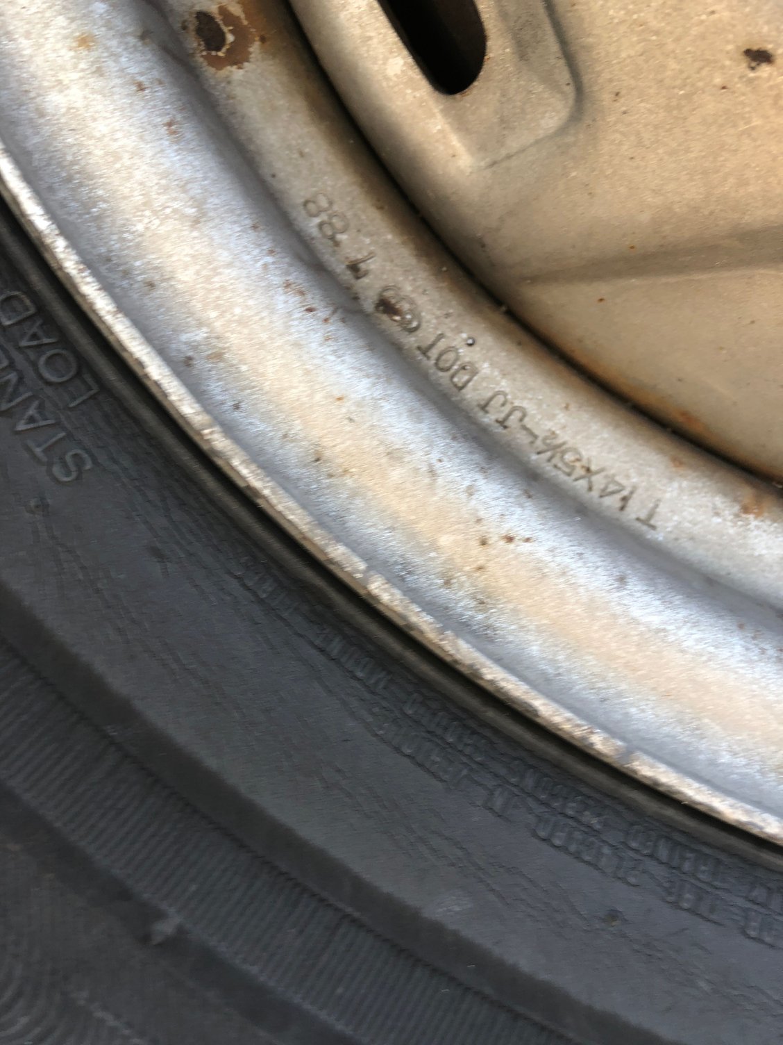

Current rims on my pickup
Numbers on current rim

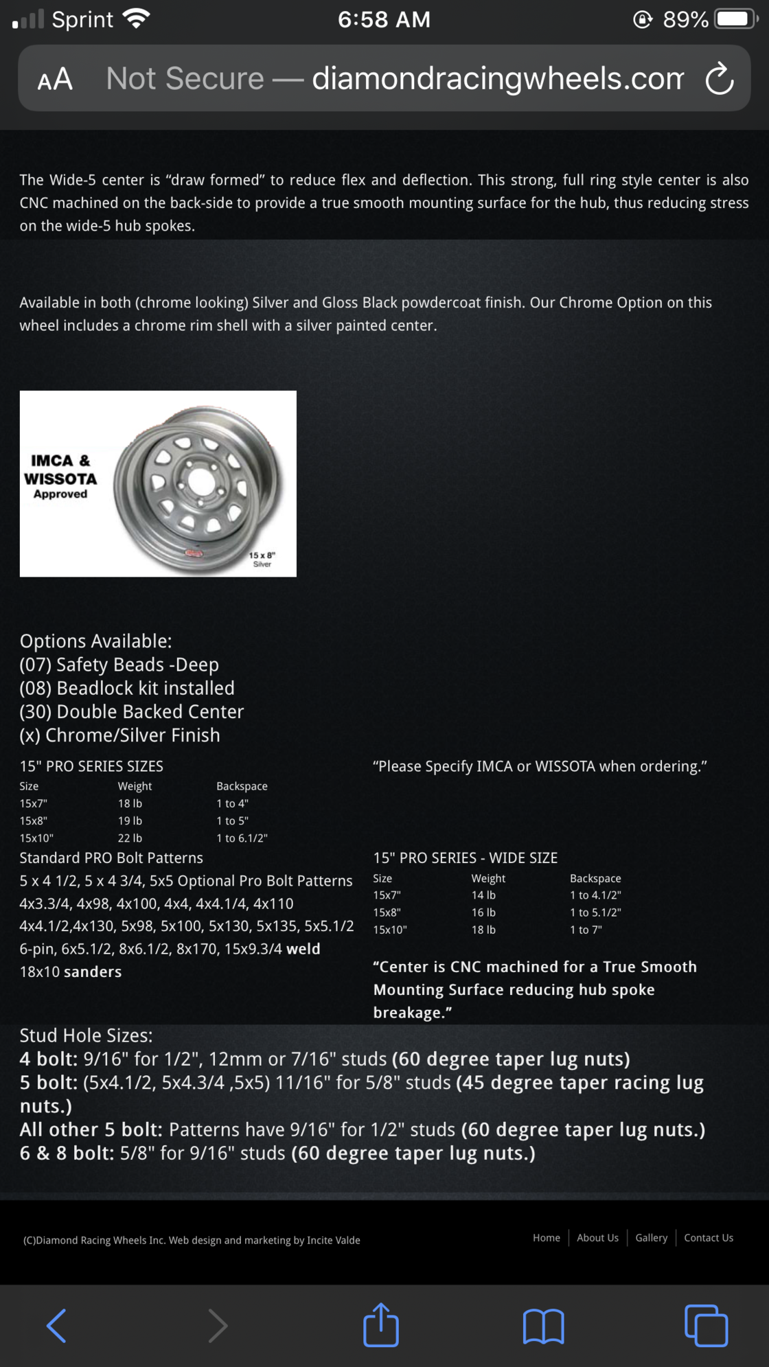

ok they didnt fit lol. But now I have a set of diamond racing wheels. Problem is i dont know what lug nuts to use. 45 degree or 60 degree. I dont fully understand their bolt size expansion on there site.
The stud hole size section. Which lug nut would you select for a 1988 Toyota Pickup? Bolt pattern is 5x4.5 studs thread is 12x1.5.. This is what i dont understand: 5 bolt: (5x4.1/2, 5x4.3/4 ,5x5) 11/16" for 5/8" studs (45 degree taper racing lug nuts.) All other 5 bolt: Patterns have 9/16" for 1/2" studs (60 degree taper lug nuts.) What di they mean 11/16 for 5/8 studs?

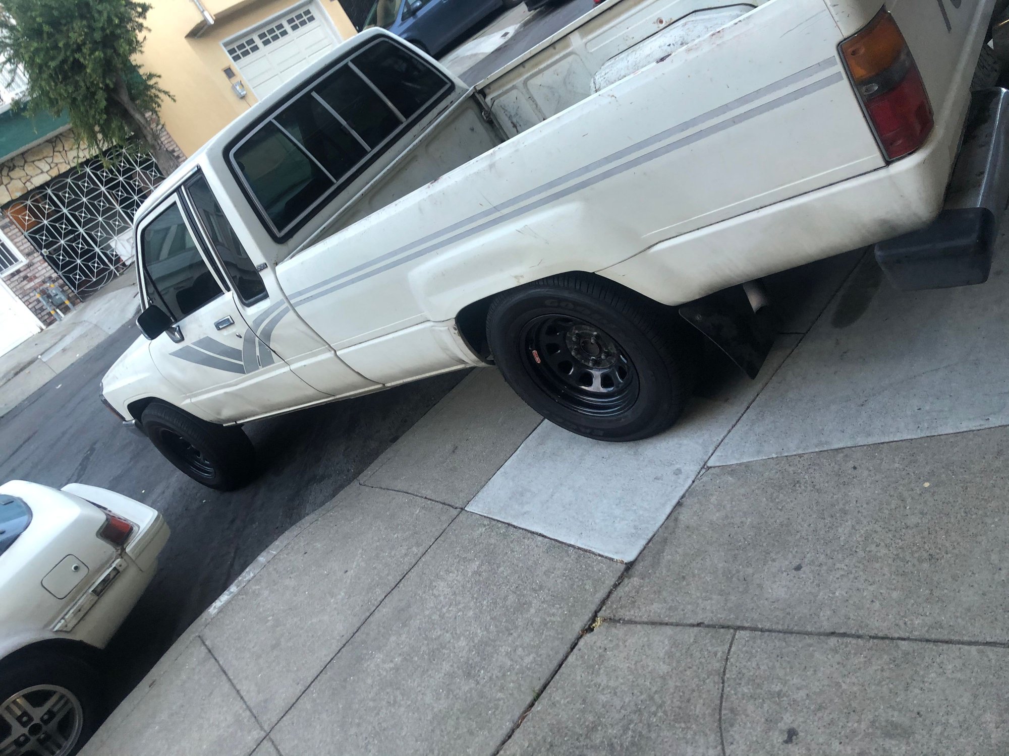

Here a picture of my truck with the rims.

"What di they mean 11/16 for 5/8 studs?"
Their rims come with a 11/16" hole for your 5/8" wheel studs. So essentially, the hole in the rim is 1/16" larger than the studs.

so i would use the 45 degree ball seat lugs?
Contact their customer service for clarification. I prefer email so I have it in writing.
