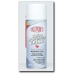

I'd wire brush the hell out of it, then grease it up - obviously be sure to cycle it back and forth a bunch of times after you grease it.
I'd recommend getting an aerosol white lithium grease - that way it will expand within the mechanism versus the liquid/gel grease that is hard to get any penetration with.

hey fink where can you get that at???

I got mine at Toyota but you can get it just about anywhere.
I know O'Reillys carries DuPont...
