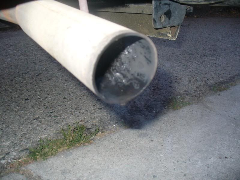

I took some pictures of the engine and i see one plug that is not conencted also the tail pipe released alot of water/ liquid. Please see the pictures.
and the tail pipe. there is a brand new O2 sensor, cat and muffler.

The water in the exhaust is just condensation. It varies by location and vehicle. All three of my 22res have "produced" about that much in the morning and and evening, especially in the spring and fall.
