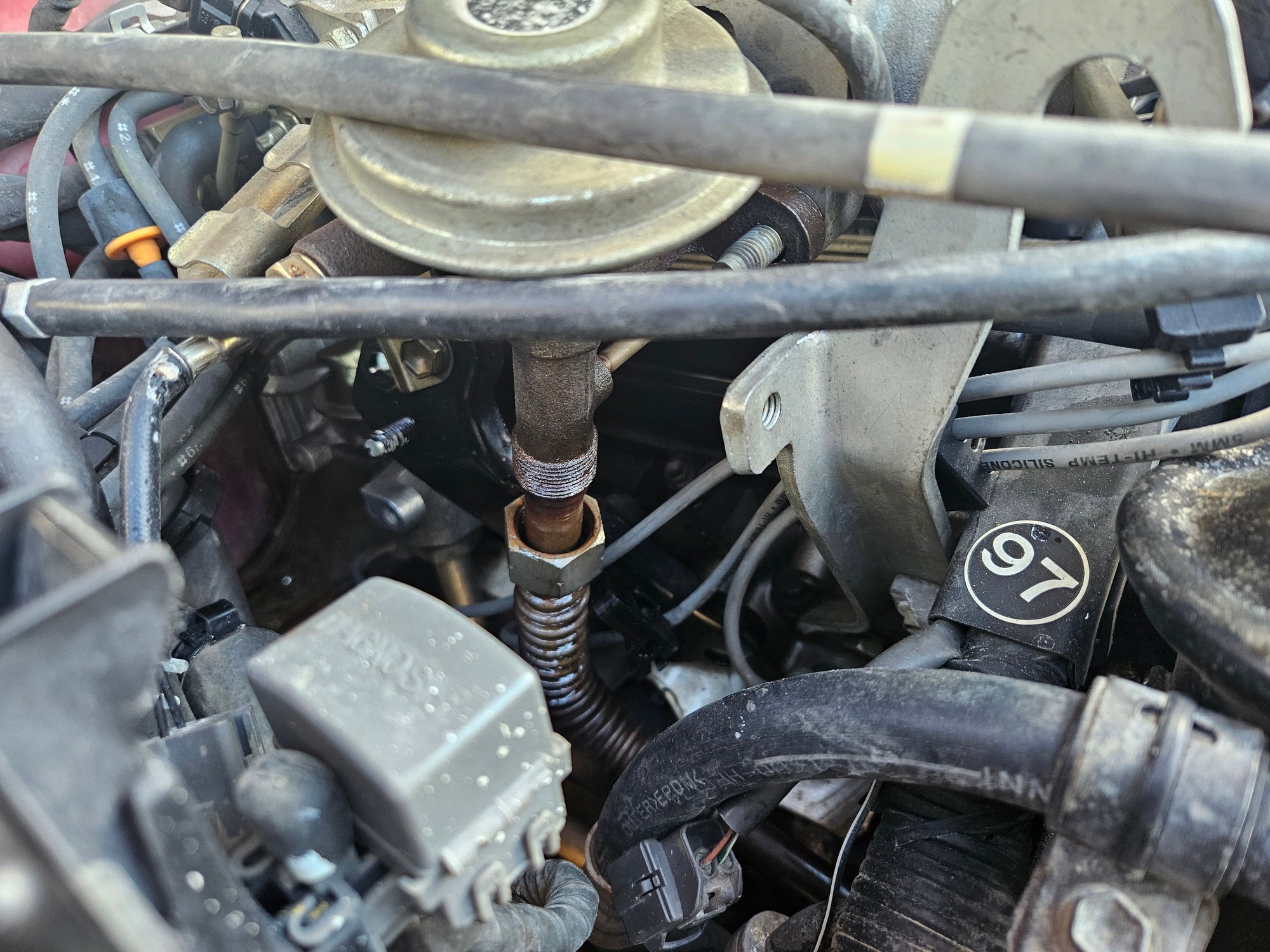

.I am down to just the pcv hose under the plenum, but I cannot get the egr pipe to seperate as it is rusty. I soaked it in pb blaster. I need it to seperate so I can get the pcv hose off.
What is the right way to do this?
Thanks

is this the one with the large hex nut between the intake injector and front of the motor? if so, using a large set of slip joint pliers helps removing that nut. When it's rusty like mine was and I'm sire yours is, it gives you just a little more wiggle room on the pipes but is also necessary to separate that part bolted to the intake plenum from the egr pipe.
Let me know if its not the same one though

It is.
I got the nut off but the pipe won't seperate.
I see they don't make them anymore so a little worried about breaking it.
It's also hard to get pb blaster sprayed into that connection.
Maybe i can use to pipe wrenches to try and twist in opposite directions.
Thanks

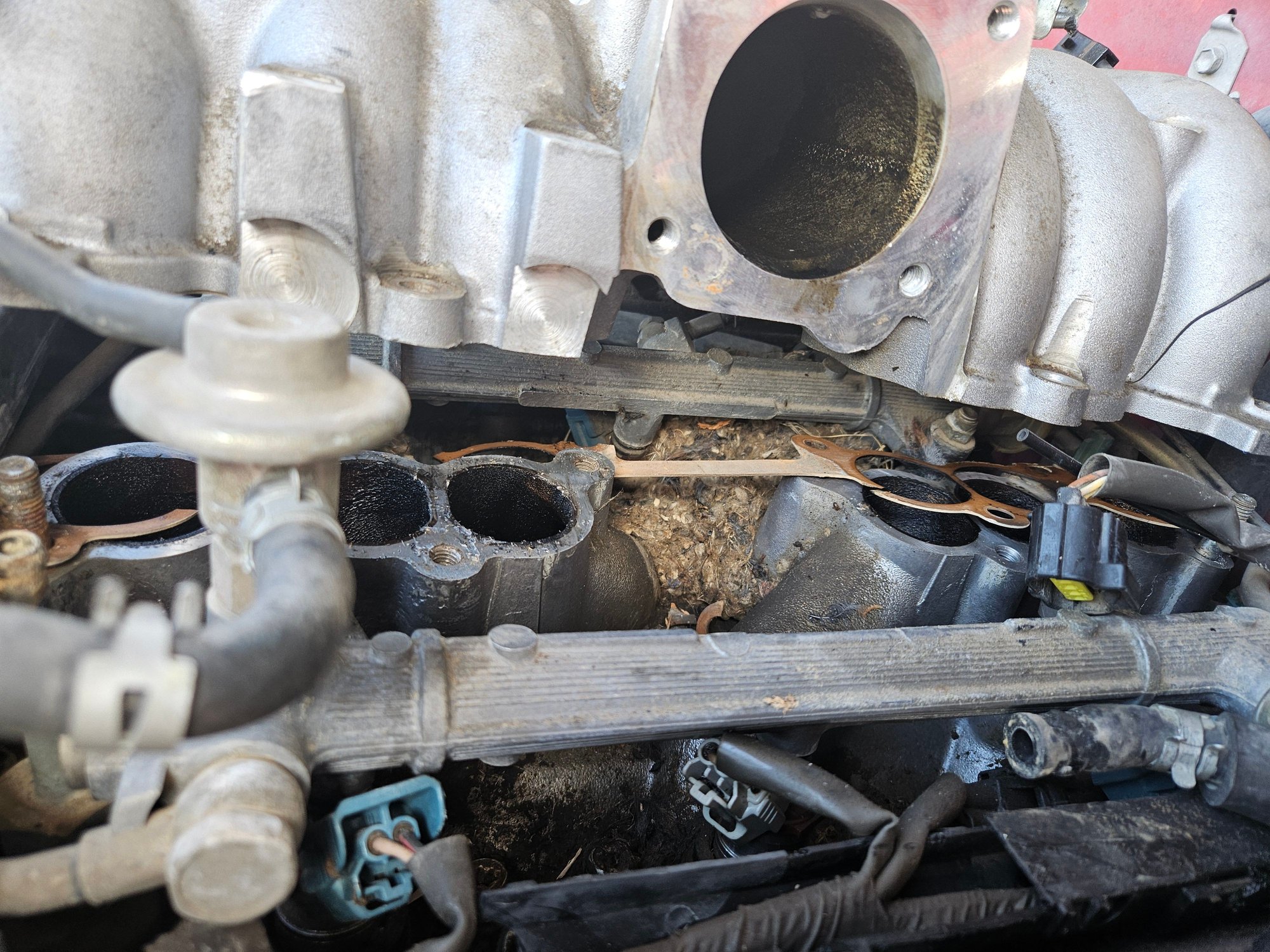

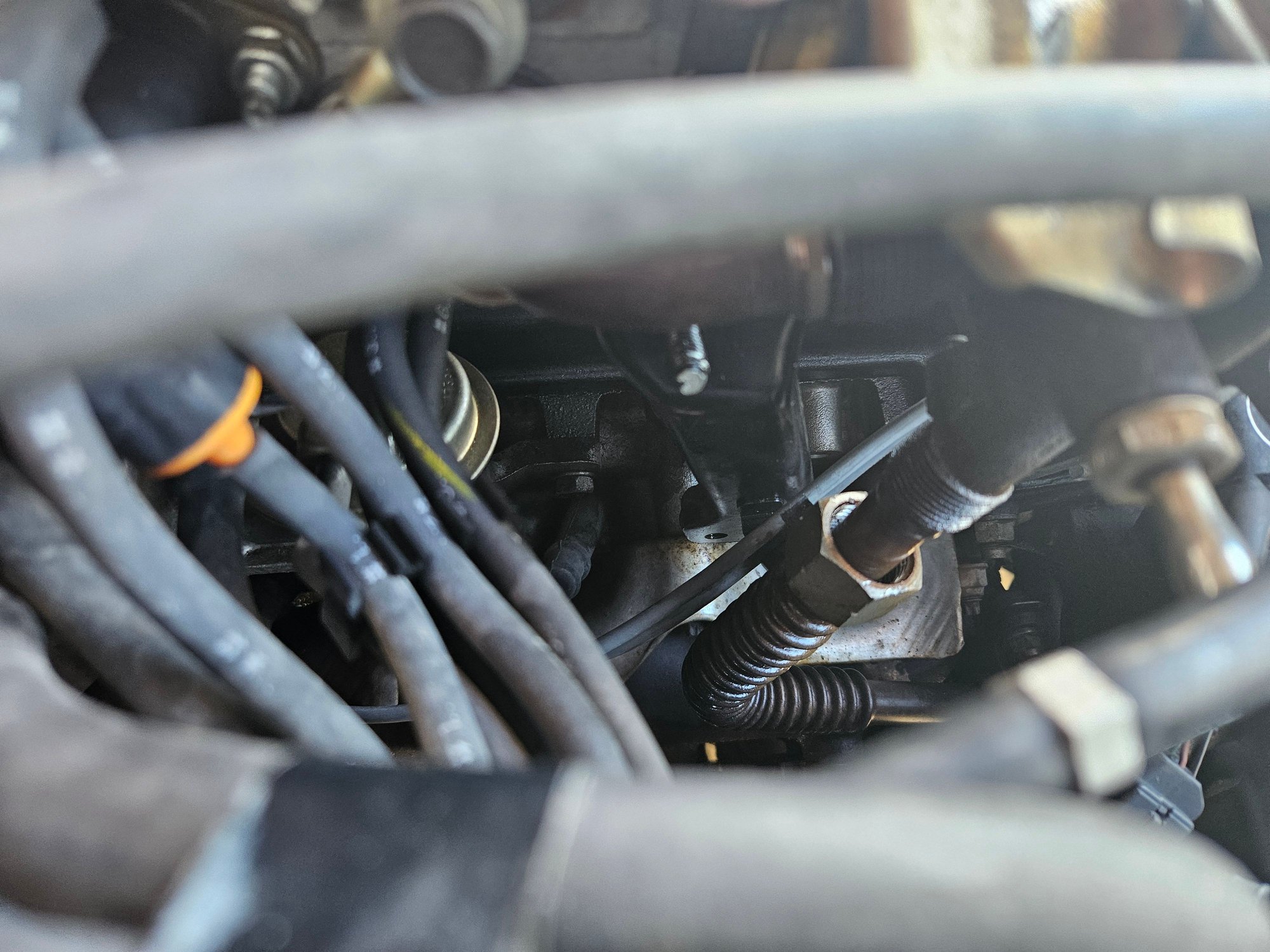

Man i am about to give up and just replace one valve cover gasket, the manifold gasket and the throttle body gasket
Here are some pics. If you see something i missed please let me know.
Thanks

Coolant pipe to the heater core stuff at the rear of the motor? Maybe coolant hose to the sensor block at the rear of the motor. It looks from the pics like you have movement on the front and drivers side but not so much on the passenger and backside, like thats where its hanging up. Thats the only thing I can think of that is hiding back in all that mess that you didn't take a picture of. Definitely helps if you try to trace all of those hardlines to their end locations to make sure none are still plugged into anything you forgot.
Please kick out Stuart Little when you're in there. Thats a crazy lookin nest.

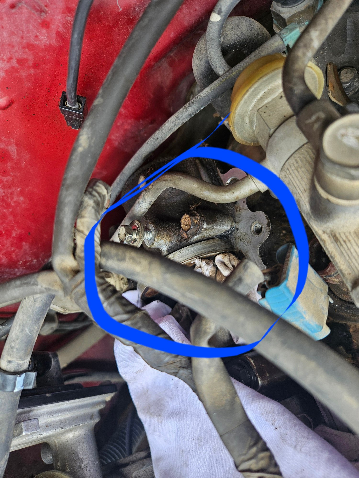

I am trying to identify the name of a hose that is cracked so I can get a part number to order.
I attached a Pic of the hose.
Any idea if the name of it?
Thanks

Ah there it is, I remember that one being a nasty pull the first time. I replaced my egr hoses with silicone ones, from a kit off yotashop I think. I would recommend finding that hose exactly or taking the part to a parts store and referencing it with other hose diameters they have in stock.
I use partsouq to find part numbers right now with pretty good success. Great database with exploded views of most parts diagrams.
Is that the hose to the reed valve? If so partsouq gives a part# 1734165010 which is discontinued I’m finding. 3vze reed valve hose should probably bring up some results though.
Good luck, and glad the plenum finally came off
