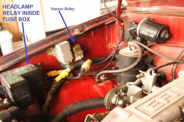

Thanks for your response. I am more than willing to learn! and you're right dumb comes in many forms lol.
I'm going to get out and tinker with it tomorrow. I can provide more pictures tomorrow night. I plan on yanking all the starting parts and taking them in to be tested, including the new starter. I'll be sure to check the battery cables then. I can tell you off the top of my head that there is no corrosion on the battery and the terminals look good. I'll learn more tomorrow though.
As far as the 'solenoid resister' i was referring to...
Name:  rad4runner-albums-startingcircuit-picture25099-starter-relay-right-hand-side-engine-com.jpg
So what I was referring to is in the picture directly to the left of what is labeled as the starter relay. I took it to the toyota dealership and they looked up the VIN (its the original part so wouldn't surprise me if it was bad after 27 years...) and said it was the solenoid resister - $210 just for the part.
Also in the picture is the charcoal fuel filter I was talking about. Kind of to the right of the starter relay. I'm losing massive amounts of fuel from the bottom of that guy. The hose leads no where but I've read that it's supposed to just sit into the frame, so I'm assuming the guy that had it before me messed something up when he swapped the fuel tanks.

Toyota has some strange names for things what your looking at could very well be called a solenoid resistor by them.
It is in fact in the injector circuit and if you have a multimeter quite easy to check.
For your no start condition you might want to check if you have a poor connection on the wire going to the starter solenoid .
The fact you got it started with the beating on the starter.
Then with the poor quality of most reman parts these days the starter could have failed all ready.
Old age and if your in the great salt belt things corrode plastic gets brittle.
Nice looking truck !!
when first bought these trucks can take some work because of neglect and abuse once all up to speed they are great trucks.
