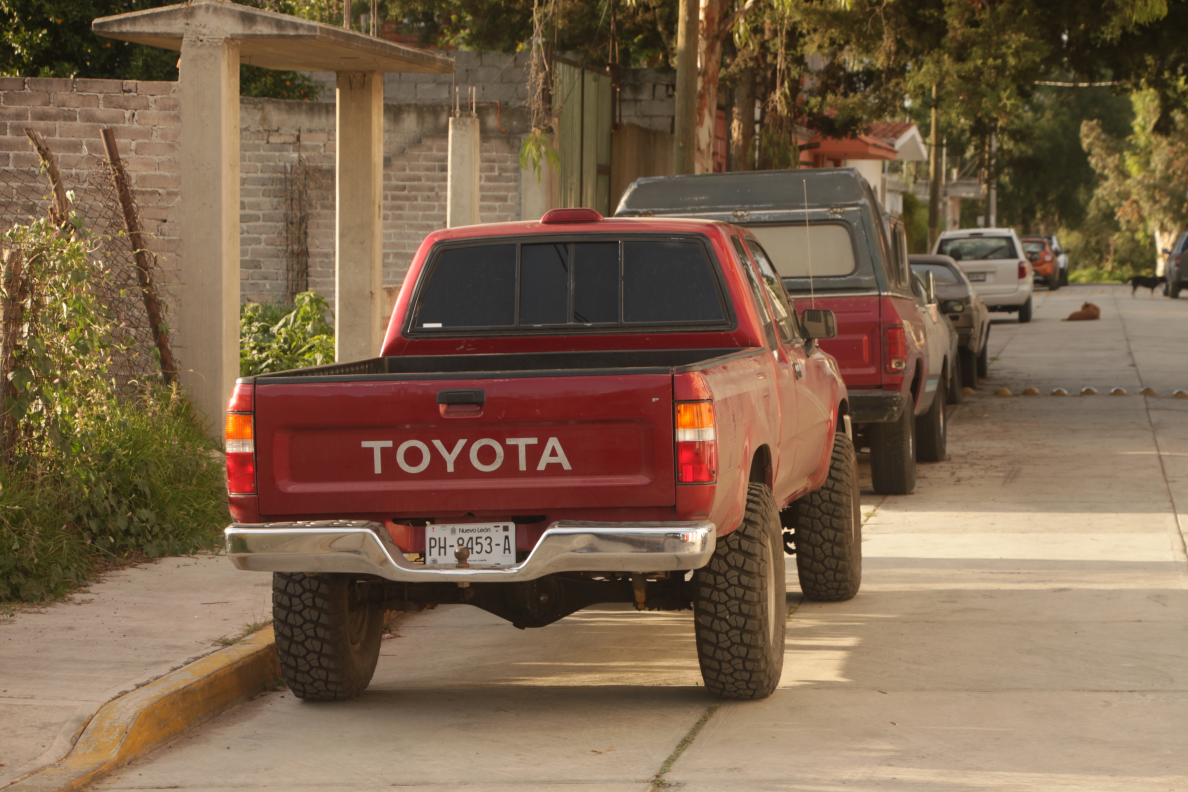

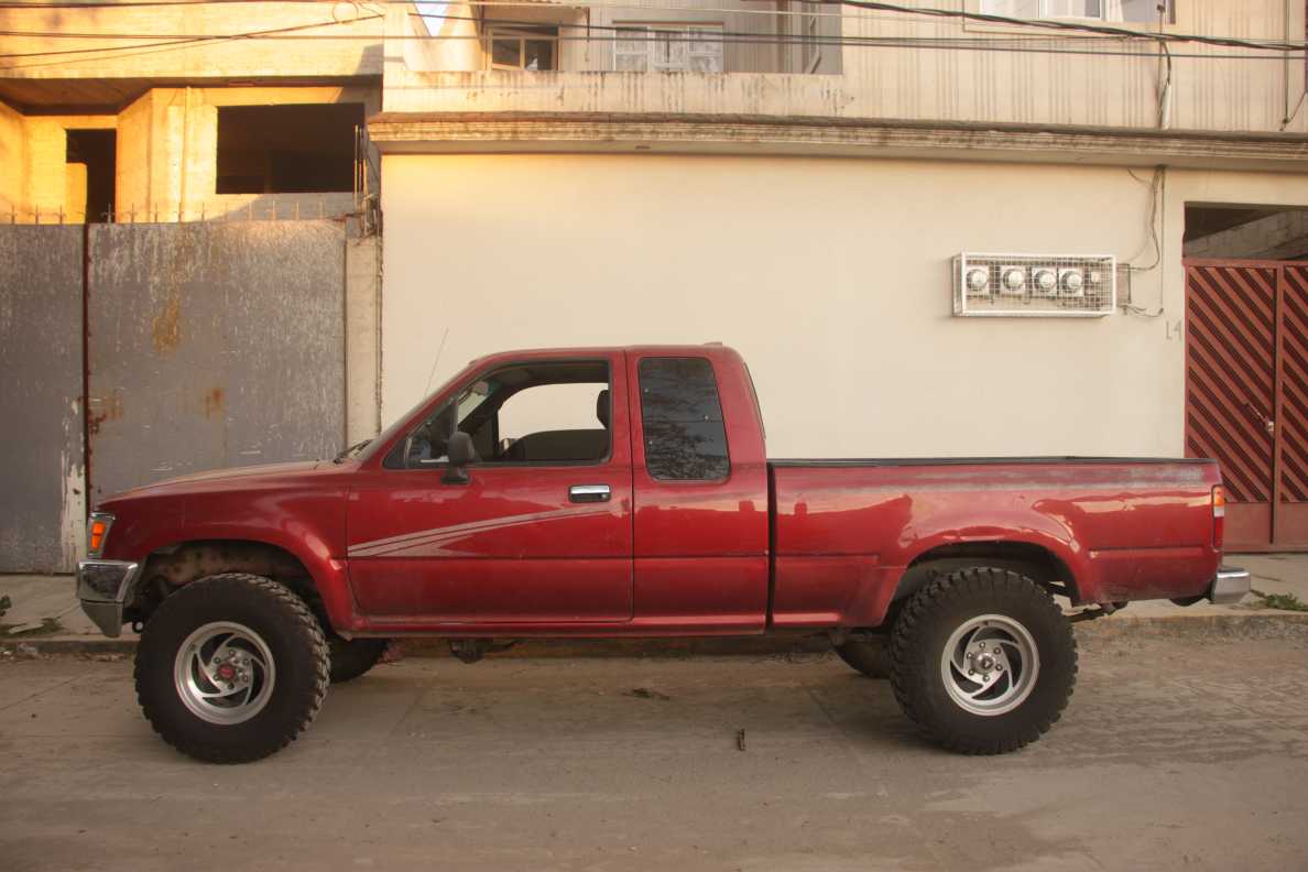

I was just reading this and other threads trying to get the correct info:
I'm currently running 31x10.5 BFG M/T on my '94 4wd pickup:
Have no idea on the specs of the current wheels (just bought the truck a few months ago), and I want to swap them for some steel wheels. I'm happy with the current setup (little extension beyond fender wells), would like to keep it as is. Truck is completely stock, no lift or other mods.
I'm looking into a set of steel Procomp 97 Series 15x8 with a 6 on 5.5 bolt pattern and 3.75 backspacing. Would these be the specs to go for?
Thanks!

You're going to have to get out the ole tape measure and measure up your wheels to see if the new ones will fit the same. Personally however I think the rims you have now look/fit great with the pickup.
