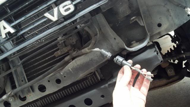

Front bumper seemed off-center (more towards passenger side)...so I pulled it.
I found the following connector hanging there, not connected to anything.

anyone familiar with were these wires should be connected to?

That is part of the A/C sub harness. Plug R2, Blue and White-Black wires, connects to the A/C Condenser fan resistor, located to the left below the V6 emblem.

Now that I'm back at my computer with image things, here is where I am pretty sure it is supposed to connect to, but seems like over time corroded or fell off.

Hey Co 94, is that something that can be just soldered back on there, I don't know it will stick or not

connections do appear corroded...
mystery solved.
thank you

Yeah if you can find anything to reattach it to. Or just by pass it and connect them together, turns the low speed on the fan to the same as the high speed.
Relay #2 turns the fan on, relay #1 bypasses that resistor.
Can't locate it(resistor) in the parts lists or diagrams, guess they don't wanna play today
Maybe this one 0.68 OHM 50W but I suck at power calculations U = R X I, 5.44 = 0.68 x 8. P = V X I, 43.52 = 5.44 x 8. Seems right but like I said
