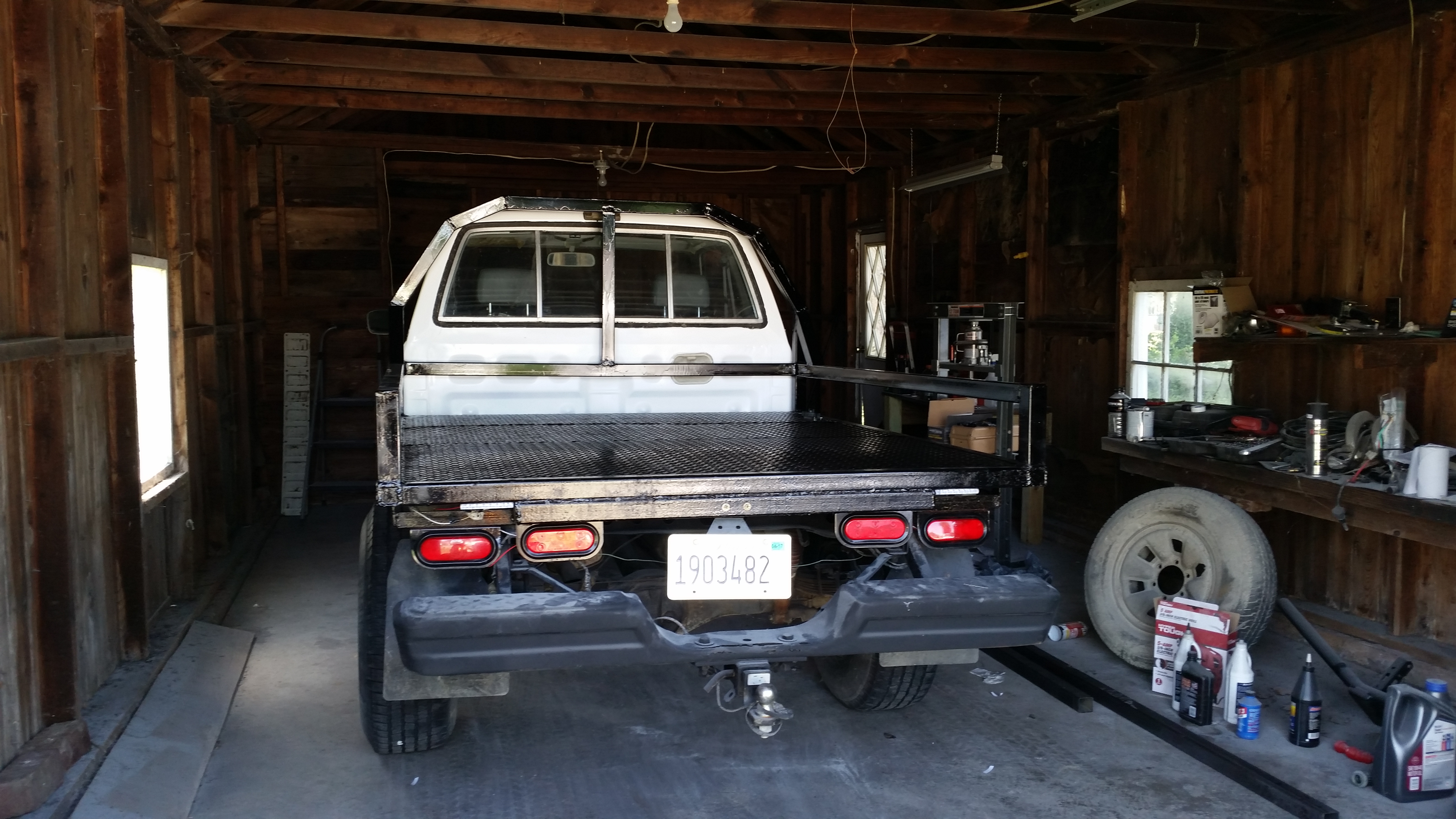

Here's the finished product on my flat bed.
Good job on the bed. Looks good!

I used the factory mounts on the frame. I have added tabs to the flatbed frame that match up with the factory mounting points. Then I drilled holes in the tabs and bolted them to the old bed mounting points.
