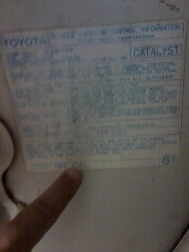

i bought my 88 toyota pickup a year ago It has had a California title. It is smog time and it failed. I am trying to fix the issues one at a time. THought i would do the simplest first., replace the bulb in the Dash cluster. i take it apart and see that there is nothing there and nothing even printed on the dummy light plastic. i've posted a pict. please help. QUESTION: does this mean this was not a california model and i am screwed? i have no idea what to do now. the other two issues BTW were "catalytic converter modified" ( for that i think i don't have the right exhaust manifold ?)and "top down center 10 off" for that i know to just get the timing adjusted.

I assume the bulb you are looking for is the CEL (Check Engine Light). That has nothing to do with California; all 1988 vehicles sold in the US have a CEL. (Missing that bulb will always fail smog. The bad news is that the prior owner took it out because it was flashing a code, and he couldn't fix it. He thought if he took out the bulb he could unload that lemon on someone who ... oh, that would be you.)
If you care about whether it's a California truck, it says on the sticker under the hood, and it will have two O2 sensors.

I did try and put a working bulb there and it didnt light up so i guess ill have to dig deeper and try to figure out why it doesnt light up. you are right it is a CA model there are O2 sensors in it. i knew there were going to be issues i got it really cheap from a guy who had bought three of them at a police auction in inglewood,ca
