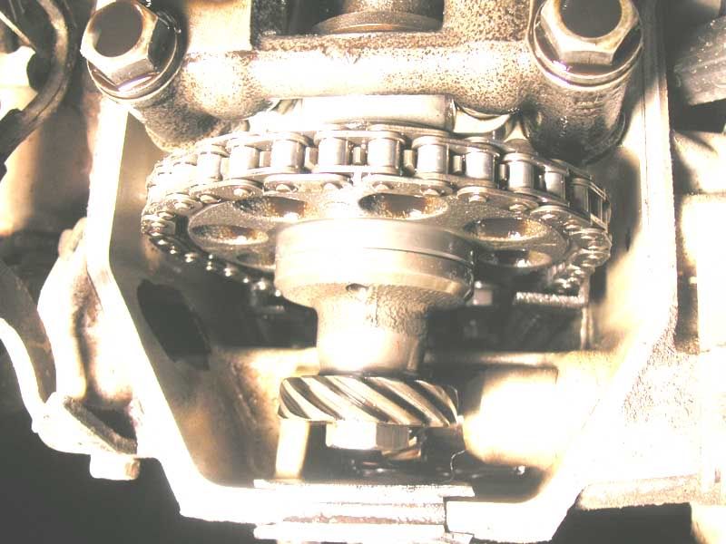

took a look at my timing chain today becuase i am trying to find the clicking noise i hear. it don't think it is the chain because the plastic guides look great, except that the left side plastic thing isnt tuching the chain, is it supose to? I am guessing that the chain was replaced with the rebuild 30k miles ago.

I'm hearing the same noise you do in my 86 pivkup with a 22r. the guy at autozone who seemed pretty knowledgeable told my to replace the guides, tried that? also, did you have to drop the oil pan to remove it, and if you did, did the front end have to come down, the chilton's book said it did. ouch! what a b*tch.

Have you adjusted your valves?
The pan can be removed w/o removing the front differential. I'll send Jovis over to the thread tomorrow. He did it on his.

Guides look like they should. Have you checked the rockers and assembaly to make sure they are in spec? Are your valves adjusted right? What does your compression look like? Are you sure its not your injectors clicking?

i guess it could be my injectors, can you hear your injectors in the cab? my compression is great, because the engine only has 30k miles on it. i adjusted the valves about 3 times, but each time i move them because they seem a little off. If i use a screw driver and press it against the valve cover, i now hear the click every ware on the valve cover but no where else on the motor. and the valve cover is tightened to spec. I mostly just took a look, because somebody told me it sounded like a loose timing chain and i wanted to make sure my guides were still good, and they look brand new.

put a stethescope on your injectors, or a really long screw driver, and listen to them. I could hear mine in the cab when I first got my truck, but seafoam and injector cleaner has helped a bit.
