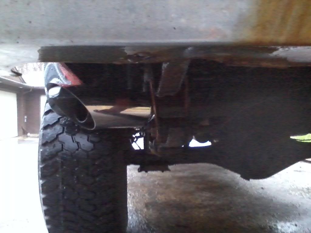

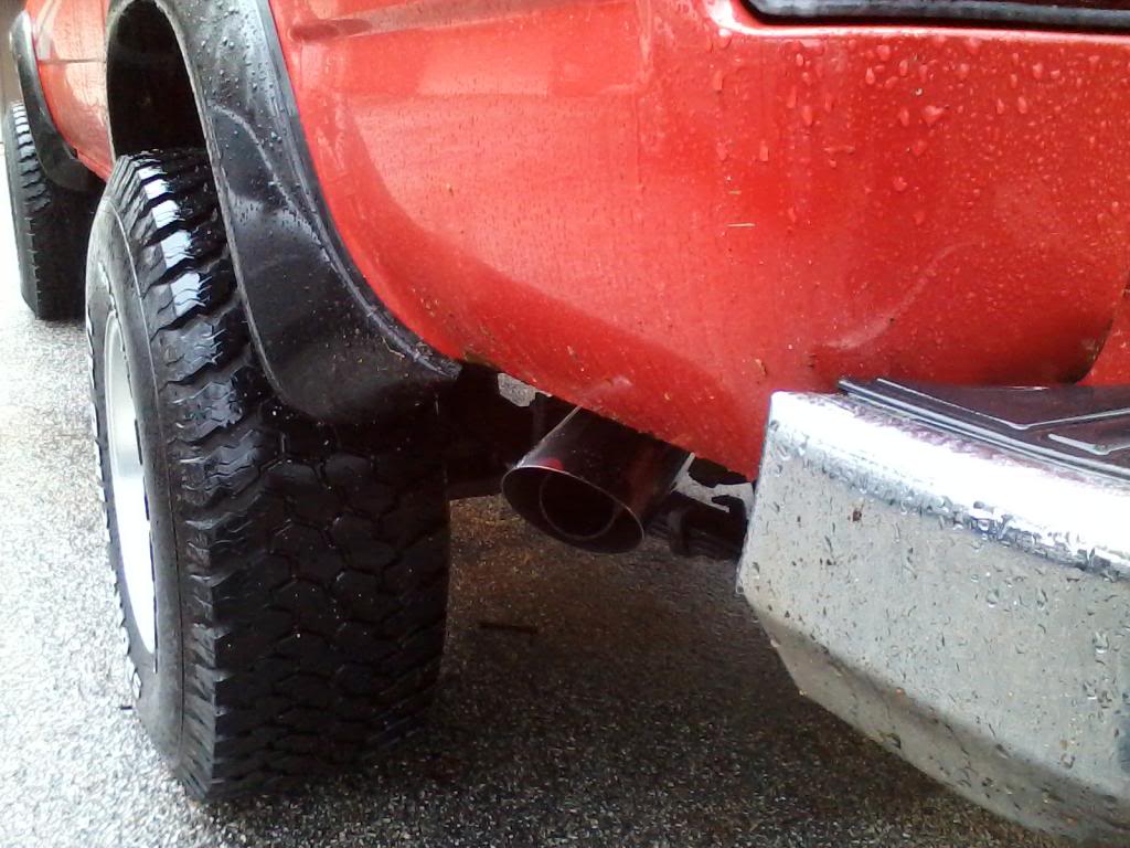

Well, I realized I ordered the complete wrong tip by accident. That's what happens when you try to rush things before having to go to class. I accidentally ordered a 4" outlet 12"m long tip. I meant to get a 3.5" outlet. Here's how it looks though. It's a little big
I'm thinking about sending it back and getting the 3.5" outlet tip, but in the 18" length since I realized I have the room. Any quick opinions? Keep this? Get a different one? Sorry to thread jack.
