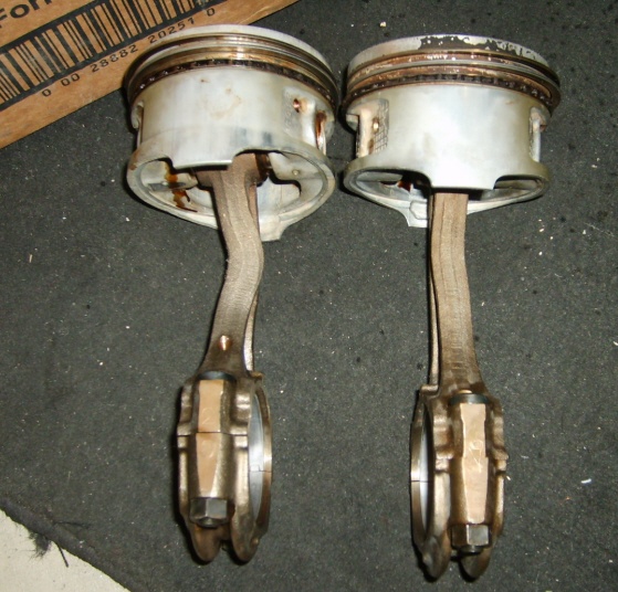

i did almost the same exact thing as you except it wasnt mud, it was just a large water puddle after a lot of rain. the truck died right in the middle of it at about 3k.
i tried starting it 2 times right after it died in the water and all i got was a loud click from what seemed like the starter. got it home and pulled the plugs and it turned over pushing a lot of water out. put the plugs back in and it started but ran like complete dog crap and had no power. towed it over to my dads friend who is a mechanic and he pulled it apart to find this.
the really bent rod had actually gouged out a creator about 1/4'' deep at the bottom of the cylinder wall. it was one of my proudest moments

Originally Posted by Robert m
just because you can turn it, doesnt mean its not screwed...
I can agree with you completely. Although I didn't get the cool rods, but I did got a cool ventilated block autographed by my rods.
