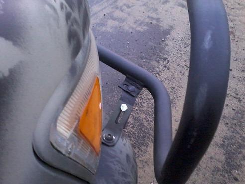

This is the bracket underneath bolted to the tow hook.
This is the small L bracket in the middle of the bumper where your red ties would be.
This is the bracket at the corner. Not necessary but it keeps the ends from vibrating.

You can see in this pic how tight mine sits to my bumper.
