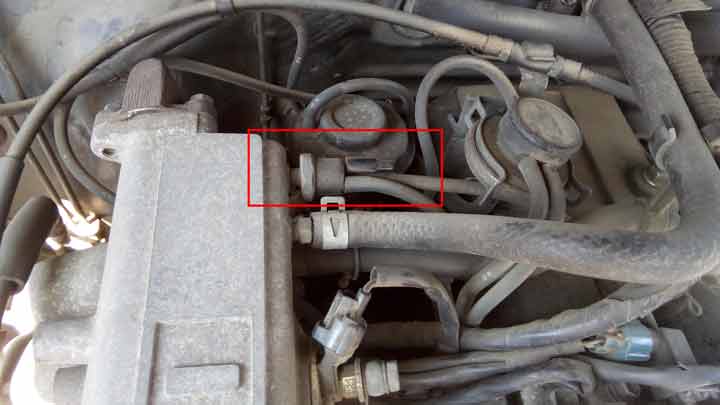

1. A vacuum tube hookup that is purposely blocked.

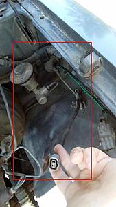

2. A wire and connector coming from the cab on the drive side wheel well, coming through the firewall that's not connected to anything.

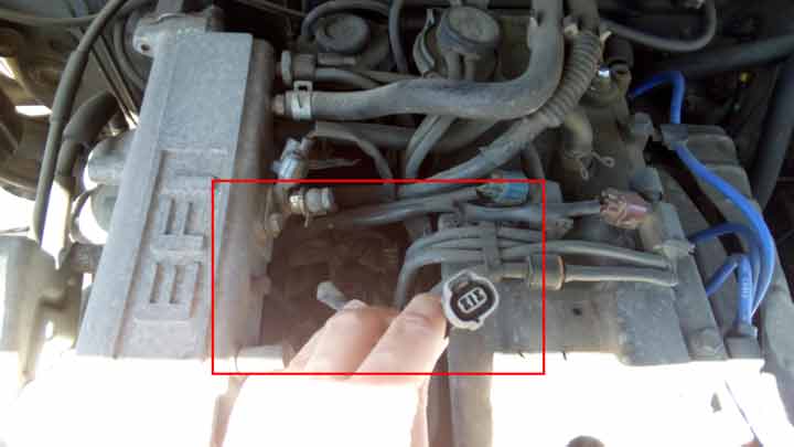

3. A connector and wire that was tucked away in the wires that appear to be coming from the intake manifold towards the engine.

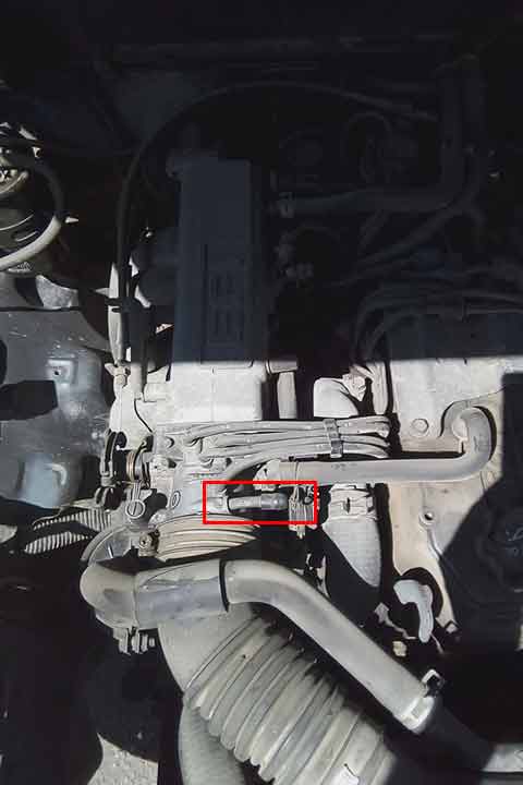

4. A weird 3 pronged connector for a vacuum tube connector at the rear of the intake, with one of the 3 prongs being purposely blocked.

#4 is the "Gas Connector", whose 3 ports all just provide vacuum. On the 3VZE, those 3 ports can go to the PAIR, Fuel Pressure-up, A/C idle-up, Cruise Control, and Automatic Differential Disconnect. If you don't have 4wd, A/C, or Cruise, then the extra port is factory-blocked with a fitting like you have.
