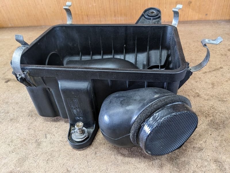

When I pulled the air intake assembly I found the air filter box a mouse condo. I added the aluminum screen shown below, and that has kept them out of the air box.

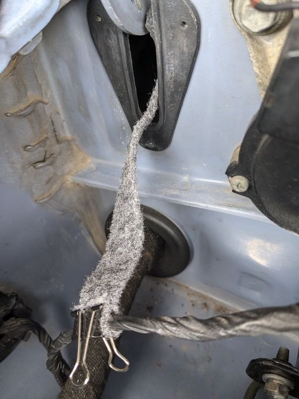

I was excited that this kept the engine bay free of mice for over a year. Then, after I was away for a month, I returned to find the engine bay mouse free but the mice had set up camp in the blower cage. Through searches in this forum, I learned where the fresh air intake is located under the cowl and how mice use that path to enter the blower cage. I saw someone's elaborate and difficult solution to cap the air intake under the cowl with screen. But I didn't want to go to that effort. Again, once a month I add about a dozen drops of peppermint oil to a long piece of the same thick felt and I feed that felt into the passenger side hinge opening in the engine bay. That gets the peppermint close to the air intake and has kept mice out of the blower cage for almost a year now. Maybe this solution will help someone else with a mouse problem.

I never had any mice inside the cab, only in the blower motor and engine bay. The first post in thread Mice in blower /Cowl area has some good pictures showing the location of the fresh air intake under the cowl. The pictures show how close the air intake is to the passenger side hood hinge. Feeding my peppermint oil-soaked felt into the hood hinge opening in the engine bay definitely gets the peppermint close to the air intake and has been working for me. Some have said, they always leave the heater's air control on Recirculate when they leave the truck, which closes the flap above the blower. Others have said, that just lets the mice nest on top of the flap and soak the flap's foam with poop and urine. Peppermint near the air intake has been the solution for me.

I can't be certain. But there are many posts with mouse nests in the blower cage and that air intake under the cowl goes directly to the blower. I read somewhere that the cowl drains behind the fender so that's a path to the air intake. That single piece of peppermint-oiled felt that I feed in the hinge opening is the only thing I have done since I found the nest in the blower cage. And there haven't been any nests in the blower since, so that appears to be their entry point. Count yourself lucky that you don't have the same problem. My truck is parked in a pole barn that is surrounded by acres of pasture offering an endless supply of mice.

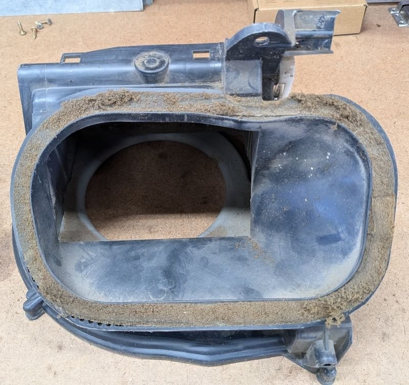

So here's a six month follow up. The once a month peppermint still keeps the engine bay mouse free. But the mice have decided they can tolerate the peppermint near the fresh air intake to get into the blower cage. That has happened several times. Leaving the blower flap on recirculate works. But if I forget to do that the mice head right for the blower cage. I decided to create a physical barrier to entry. Here's the air intake at the top of the blower housing after removal.

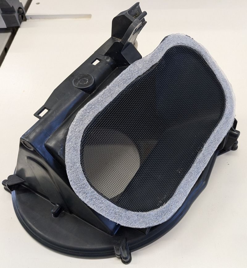

I added aluminum screen with JB Weld just like I did for the engine air intake box. Then I cut and glued a new foam gasket.

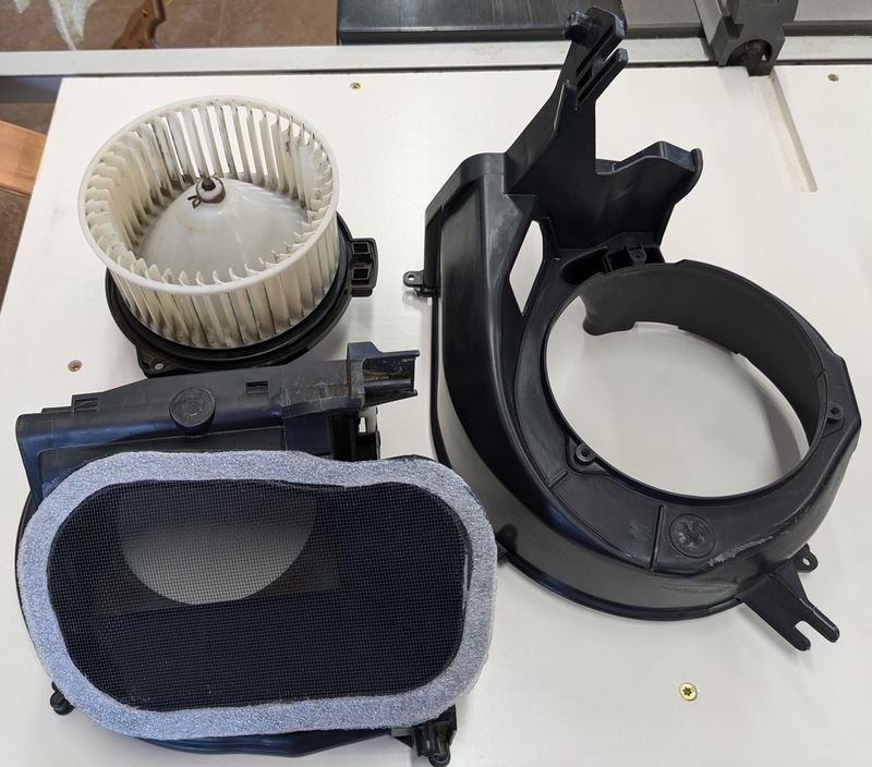

Below are the blower motor and the two parts of the blower assembly. Removing the blower assembly is not too bad if you loosen the bolts holding the A/C cooling unit. The mice could still decide to nest on top of the screen. But they haven't nested on top of the blower flap probably because that puts them too close to the peppermint. I'll post again if this solution fails.
