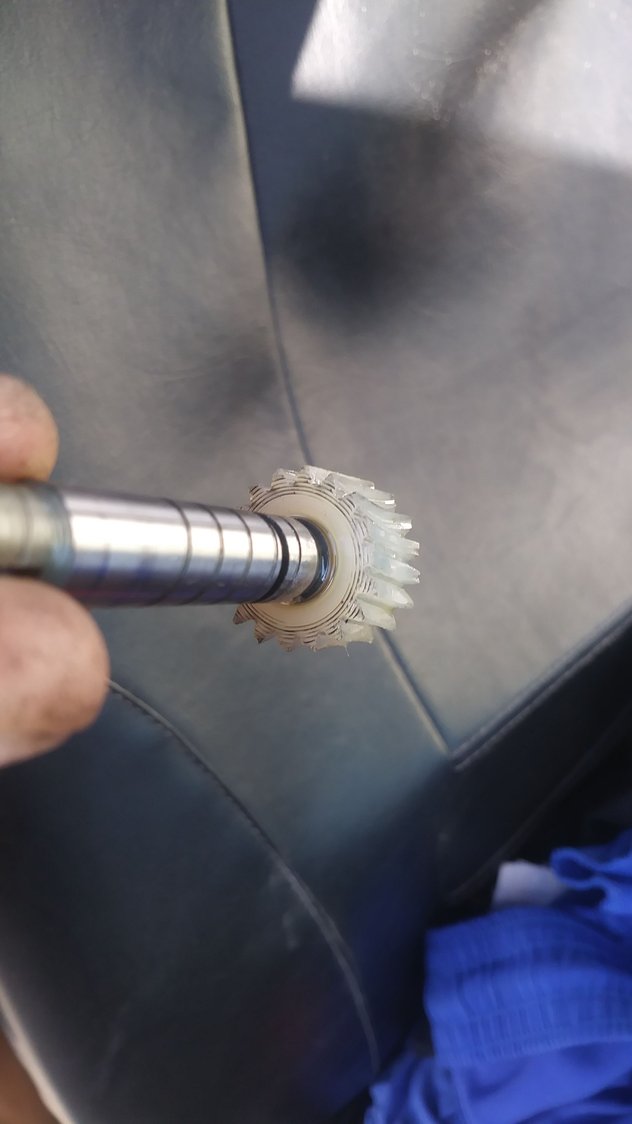

Got it. 18 teeth. Dealership wants $68 though???
How does this thing work anyway? Felt for gear teeth inside the transfer case hole with my finger but couldn't feel any ..

There's a speedometer drive gear on the transfer case output shaft.
http://web.archive.org/web/200702061.../6componen.pdf
I've never gotten that far inside my transfer case (my gears were fine; the electronic sender had died). You can see that the gears engage at right angles. I don't know how far you can get your finger into the hole, but if far enough, you should be able to feel the drive gear. More importantly, with the transfer case in neutral you should be able to jack up a rear wheel and turn it, turning the driveshaft, which should turn the speedometer gear (once back in the transfer case).
