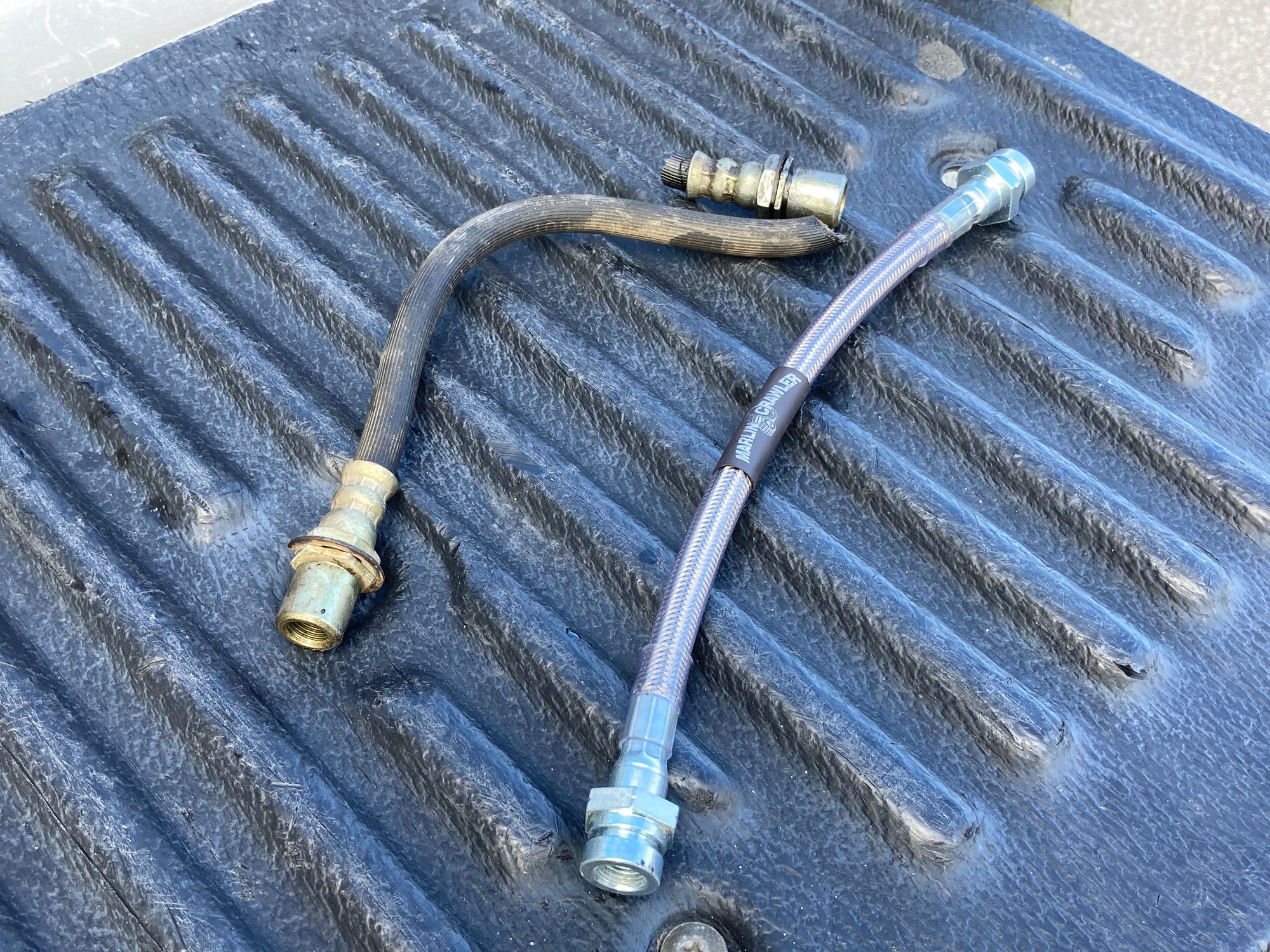

Anyone have the Marlin Crawler Steel Braided Clutch Line installed on their rigs? My Clutch hose is leaking and I want to upgrade to a Steel Braided line. I got this one from Marlin Crawler for my truck, but when I looked at the stock fittings, their a tad bit longer compared to the MC hose fittings .

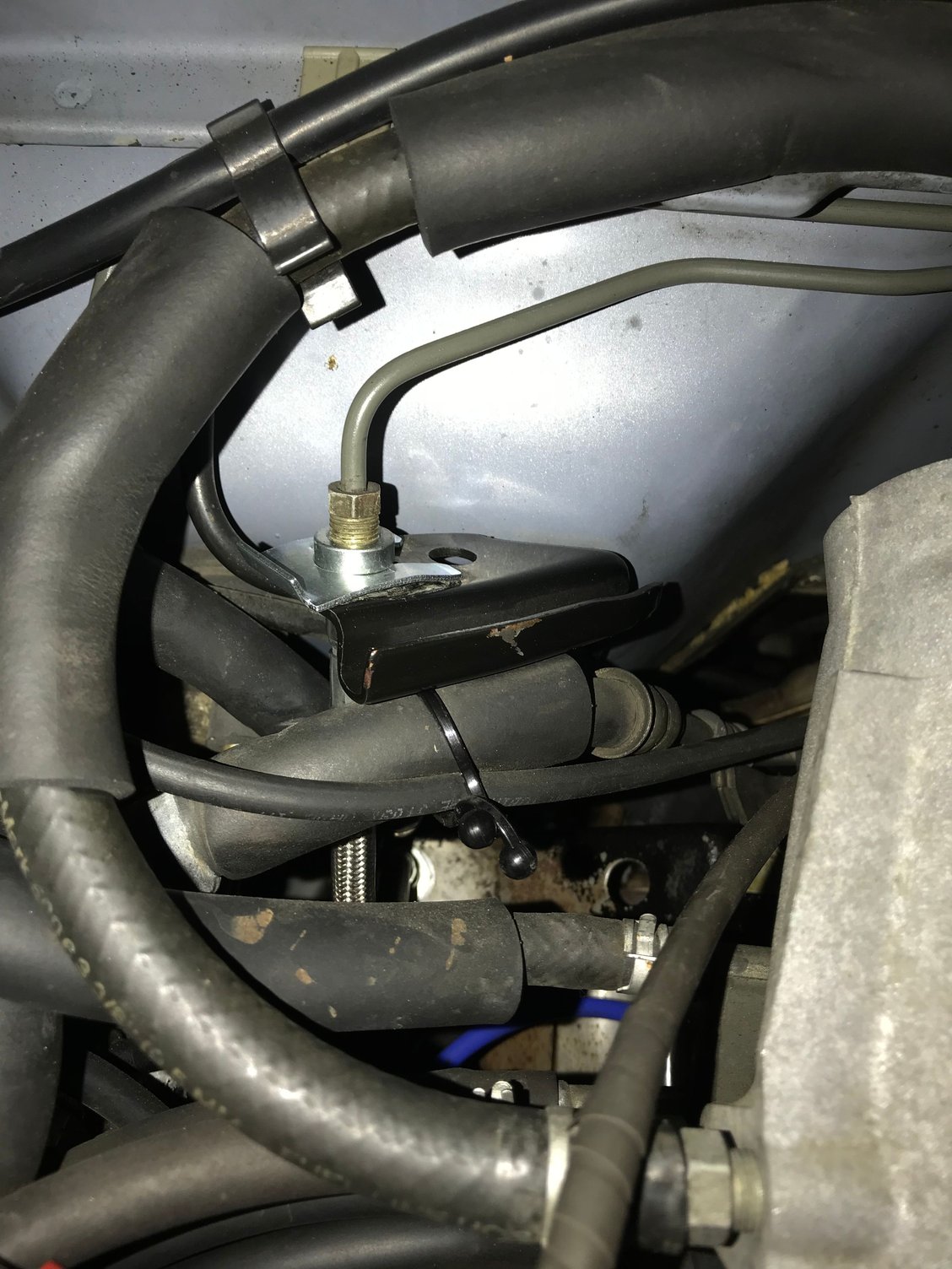

Here you go!

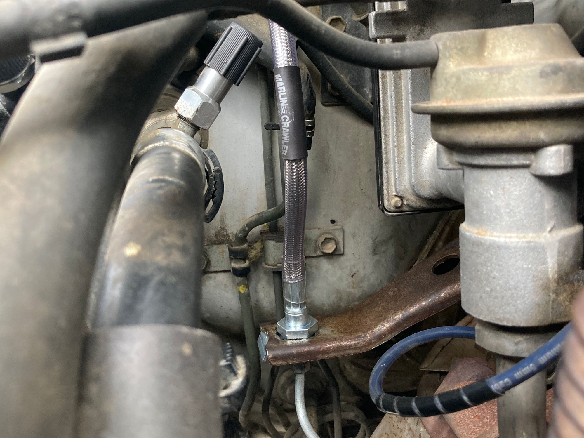

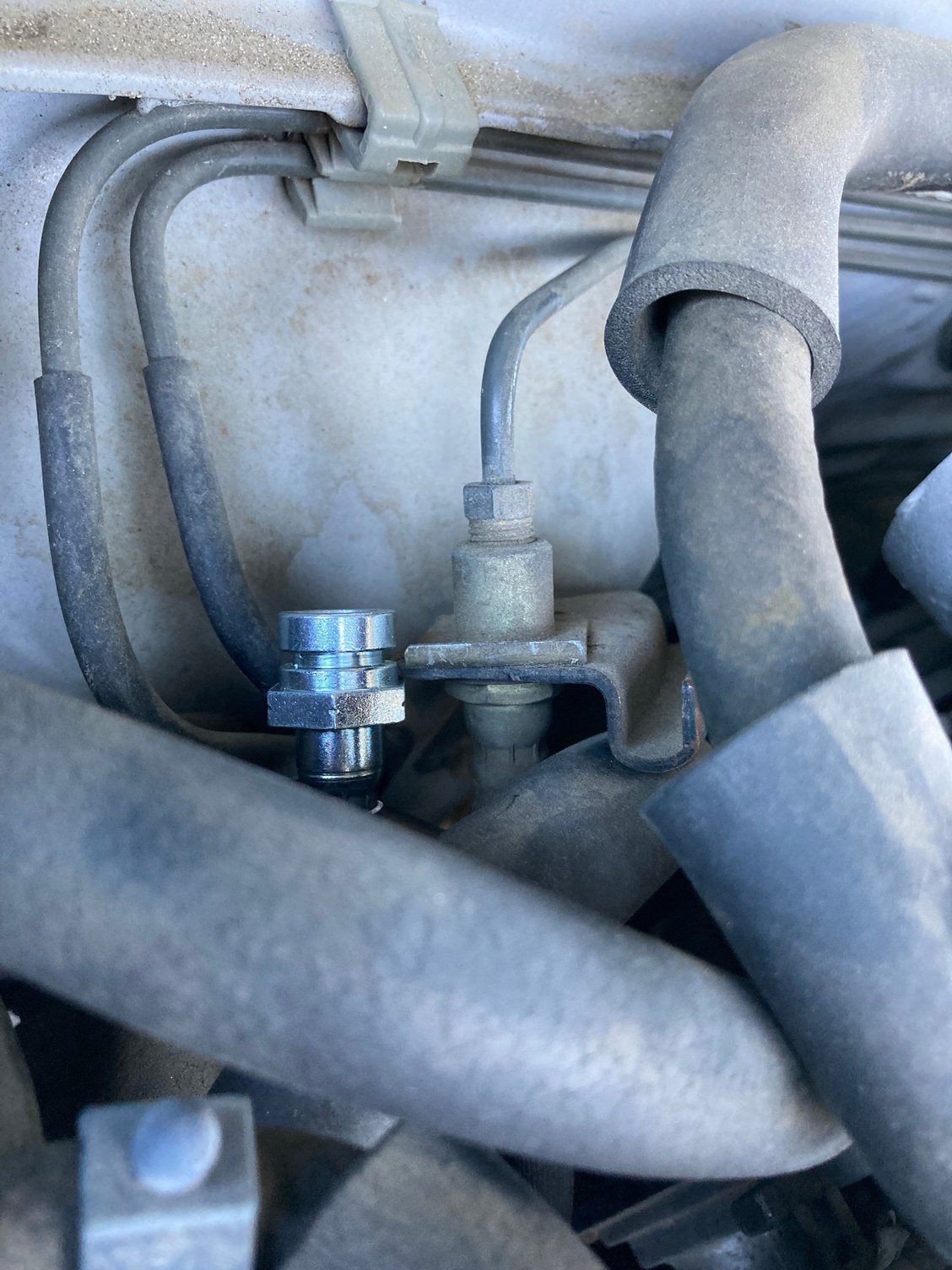

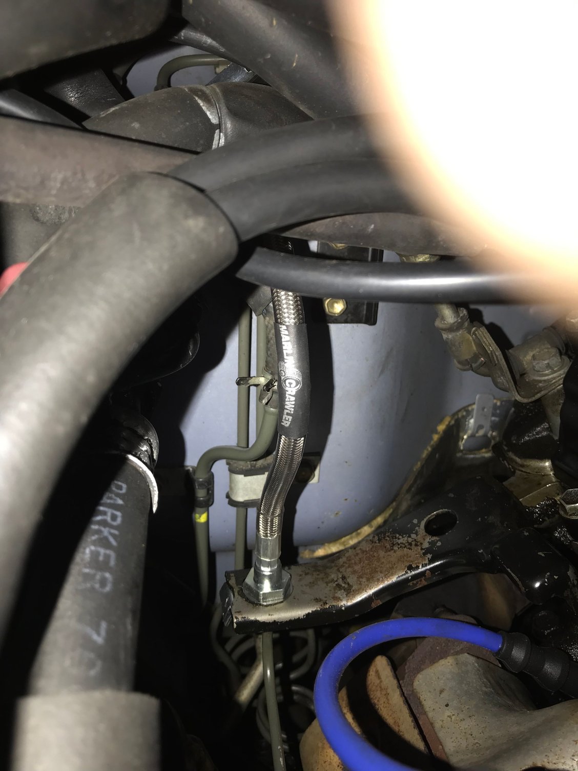

I went ahead and installed it. Taking out the original hose was a PITA but MC unit looks and works way better.
As you can see, the upper fitting on the MC unit is shorter...But it will still hook up without too much hassle.
This thing looks awesome
