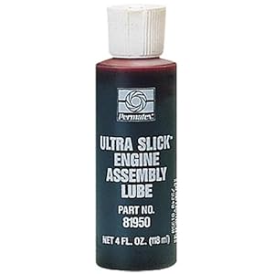

Another product I think would be worth considering (I haven't yet tried it) is Permatex "81950 Ultra Slick Engine Assembly Lube" which people use for all kinds of lubrication tasks. Nothing works better for ratchet wrenches, for example. It's VERY slippery stuff, but is probably a little thicker than Bel-Ray, and so might take some effort to work it into the cable. Also it's red and messy and tends to get everywhere. Did I say it was slippery?
http://www.amazon.com/Permatex-81950...dp/B000HBNVSK/
