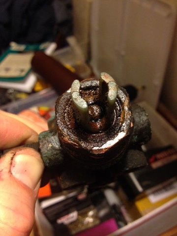

So, the valve will come in a few days (along with new seat belts! Woot!), but in the mean time, I've still got a leak. A 20 minute stop'n'go drive to work and being parked for 9 hours left me a puddle about 12" diameter. I'm cutting down on the driving it gets, and monitoring the fluid level as needed, but to fully examine what I will have to tackle when the new valve comes in, I crawled under the truck and started the exploring the LSPV and various fittings. While exploring, I tore the boot covering the valve plunger (piston?) This confirmed that the LSPV itself is leaking (rusty crusty all around the plunger and it's it pretty well seized in there) and not the lines in/out (they were dry as a bone.)

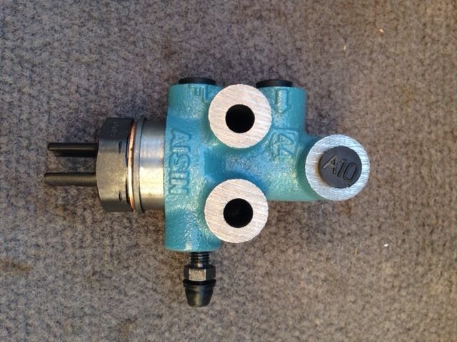

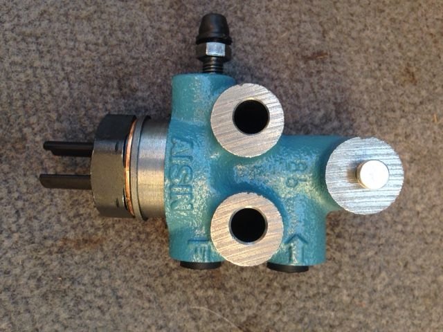

So, the LSPV. It's an AISIN bit, ordered from toyotopartsdeal.com
part# 47910-35210 (on the invoice, it also states "Replaced by: 47910-35440)
I chose this part based on what TPD brought up using my VIN.
Initial inspection showed it being the thing I needed. I haven't yet ordered a new boot, but I plan to. I am wanting to get new drums/shoes, so I'm thinking I'll have a second rear brake day when I'm not so rushed.
I pulled the old LSPV, poured brake fluid everywhere, and installed this new one. Went in like a charm: great fit, good finish. I bled the rears and the LSPV, and took it for a quick spin. I have the FSM opened to the whole brake section and the corresponding bleeding/testing/measuring spots for the LSPV and BPV, however at this moment, I'm gonna call it a good. My braking wasn't significantly altered by the leak, I just didn't want to be losing/refilling brake fluid. Sometime in the near future, I'll do some more involved testing to ensure the LSPV is working as designed (ie: with the rear heavily loaded vs. unloaded). I feel a lot better not having a leak, that's the big thing, considering this truck goes up into the mountains quite a bit.

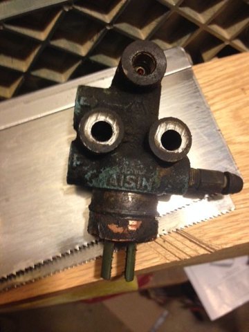

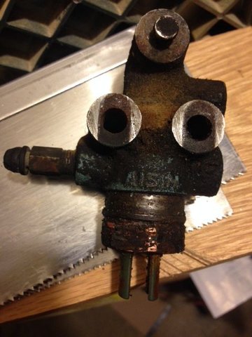

Anyhoo, here's my old LSPV. Closer inspection shows the same teal paint. Perhaps a similar replacement?
I need to get the boot ordered. I don't want this happening again!
