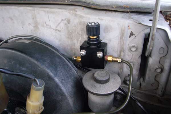

Here's a pic of mine. I used a flare kit to make the conversion ends clean...ie, cut the metric fittings off and put SAE ones on..
I have a good LSPV that I'll sell you cheap if you want it...PM me.

Heres a pic of mine too...
