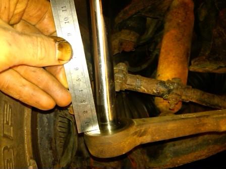

OK, I took the idler arm off and noticed that the shaft looked bent. Are they normally perpindicular to the flat surface, or bent inward towards the knuckle?
The local NAPA guy suggested that the idler arm I have may have been bent to accomodated the lift on my vehicle. Not sure this is the case since it is a 3" body lift and 35' with no change in suspension.
