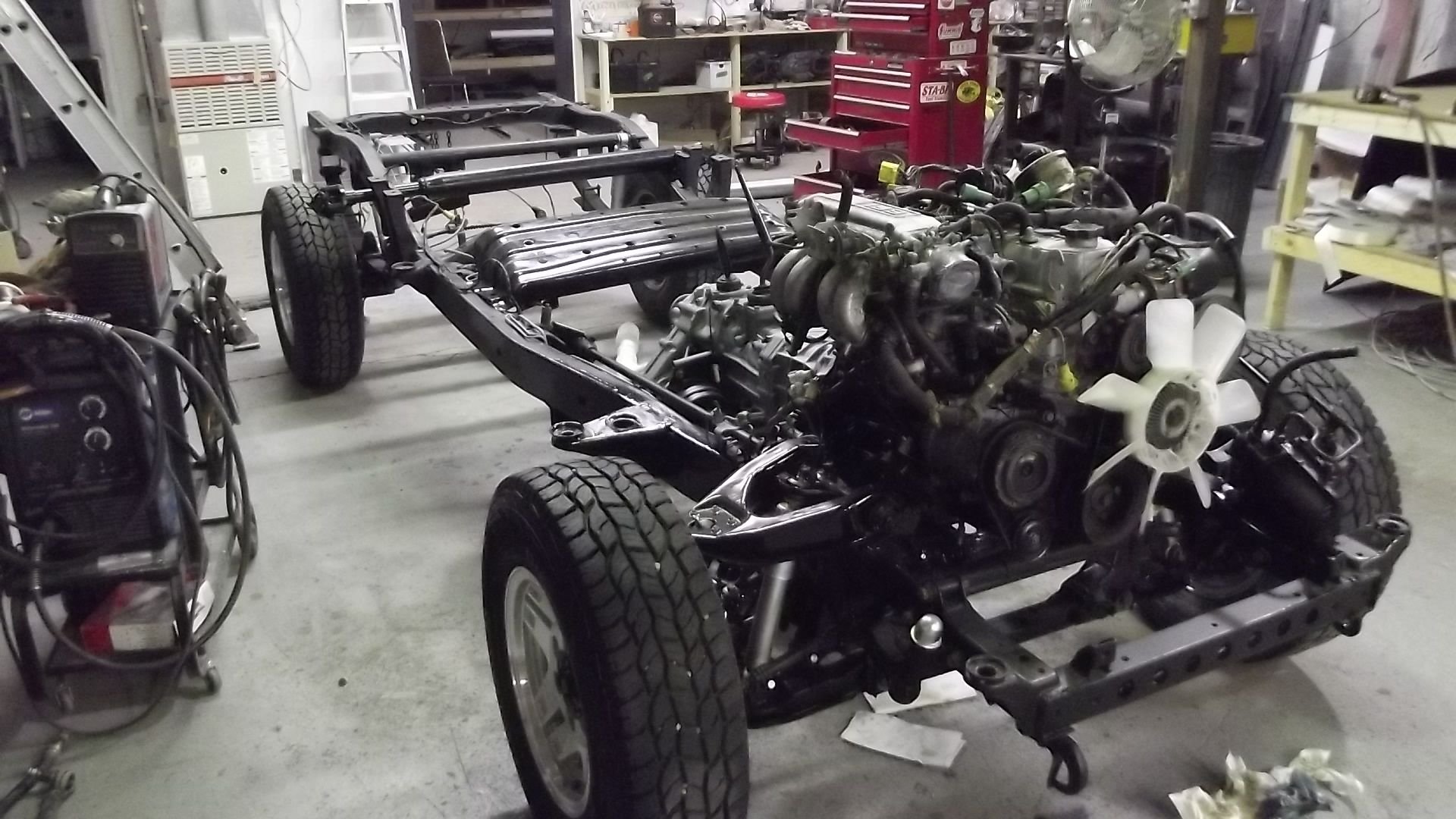

sorry for my delay , I was swapping a frame
as I tell my customers " It really just depends on what you want as a final product , and how thick your wallet is "
the parts list can be almost endless and expensive
or it can be moderate ..
I suggest , just getting under the truck , and assess what you have . and start pricing parts
