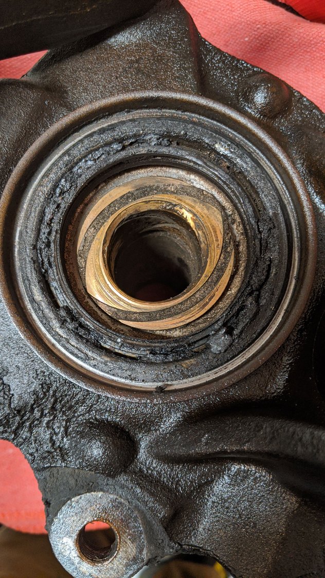

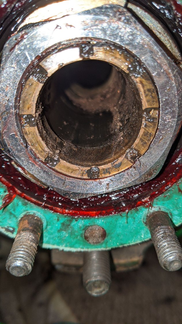

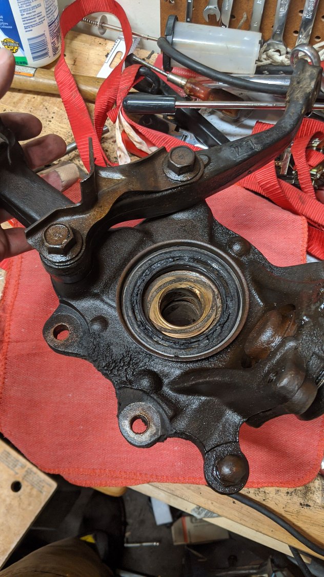

I'm rebuilding my front Left Steering knuckle, new CV (torn boot, and ruling out the possibility that it was the cause of my noise). I have what I believe is the worn/dry bushings problem, as I am finding brass shavings/dust in the spindle, and the bushings look worn as hell.
I have the new brass bushings, inner and outer. I'm waiting for a new dust cover oil seal to arrive (PN 90313-92001). I have two questions that I can't seem to get answered anywhere else:
1) How much grease should go into the spindle on the bushings? Should it be a light layer (as the FSM kinda sort of suggests) or should it be fully packed with grease? (As the post suggesting a magic threaded grease tool would produce)
2) What type of grease do i want in the spindle? I assume NOT the red wheel bearing grease. There is a product called CV joint grease, but I don't think that's it either.
Has anyone ever re-built their knuckle? What am I missing? this problem has been plaguing me every time I lock the hubs for the last couple of years, really hoping this finally fixes it, but I don't want to find the problem again in a couple of years, so trying to do it right. Pictures of the current set-up for illustration...

I would use an EP #2 moly grease and split the difference between just smeared and completely packed.
