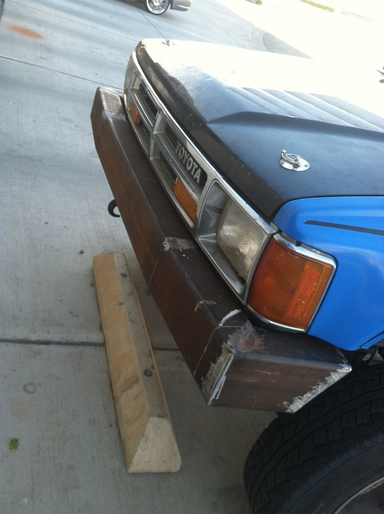

Another 2x4 bumper. Temporary solution. High and tight-clean lines. Didn't want to call a lot of attention to it. Works with those stock bumper brackets. Bumper is stronger than stock but merely a turn signal holder/inspection requirement.

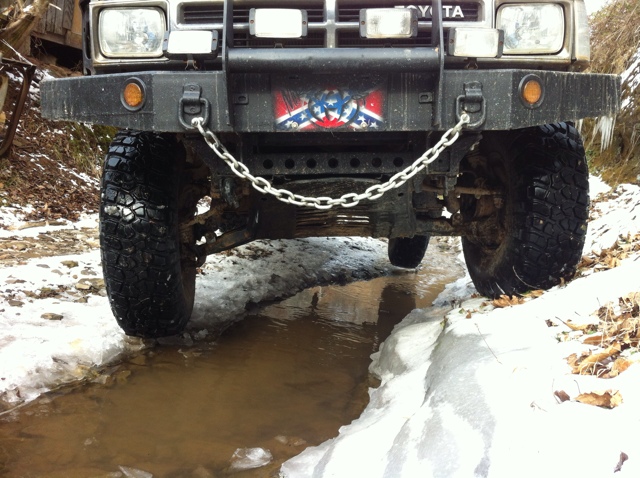

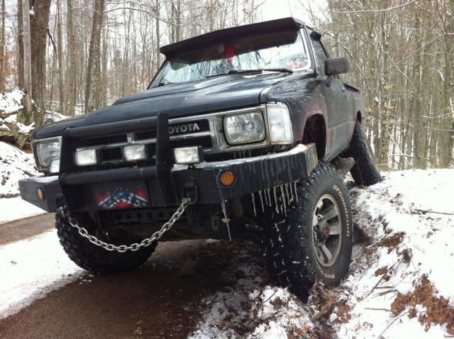

Made from 4" & 6" c Chanel and 1/4" flat steel
