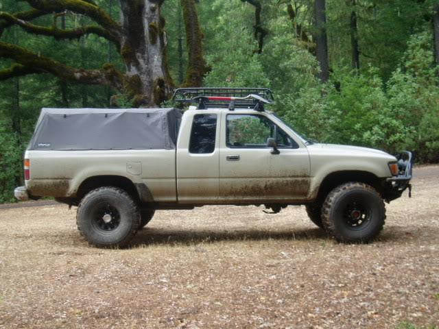

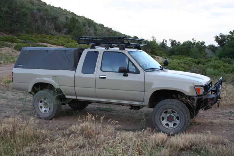

here is my 94 ext. cab
mods in sig.

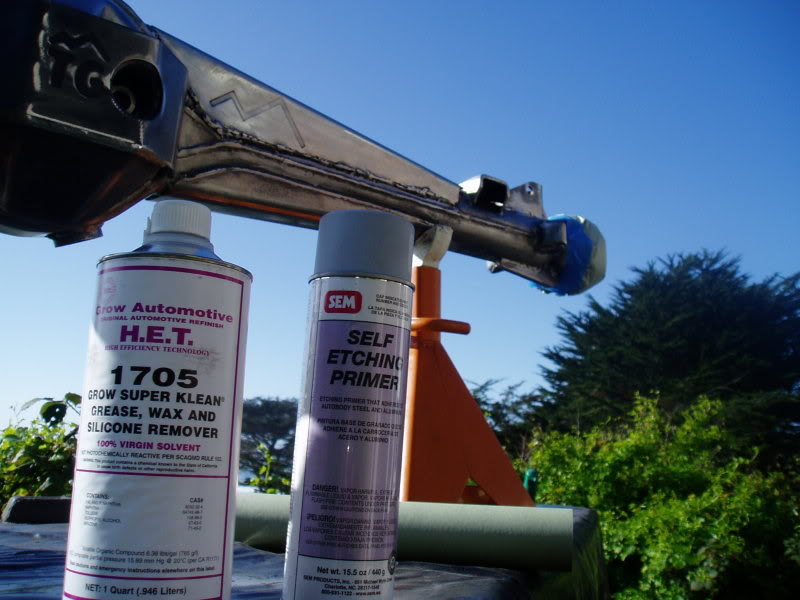

soon to get this

I love that lil basket up there. I remember this truck. Did you have the rear side windows tinted or did 94's come like that?

its tinted

I know it is tinted, I was asking if he did it or if it came from the factory like that.

No, none were ever tinted from factory... it's "privacy glass"
But that looks a little dark to be factory.

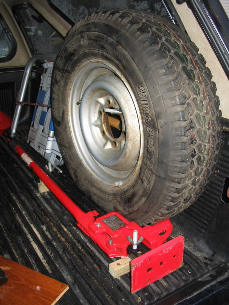

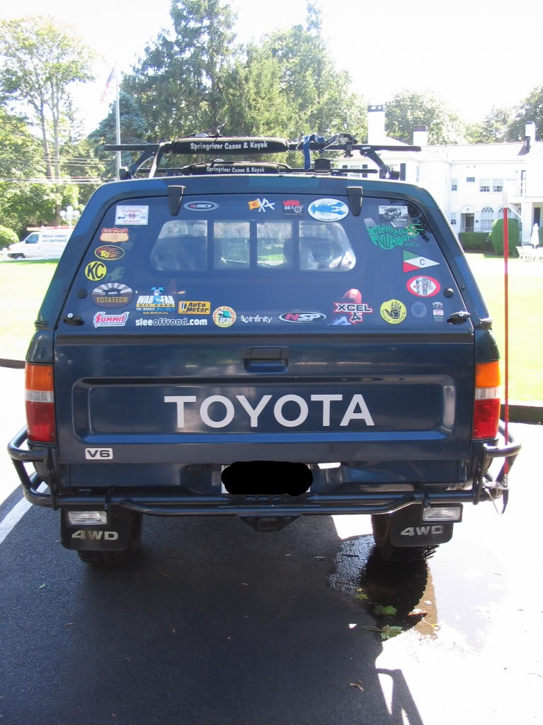

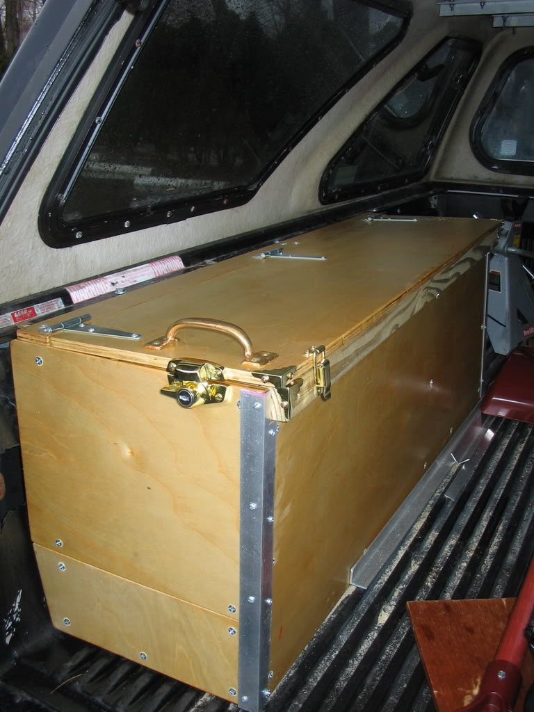

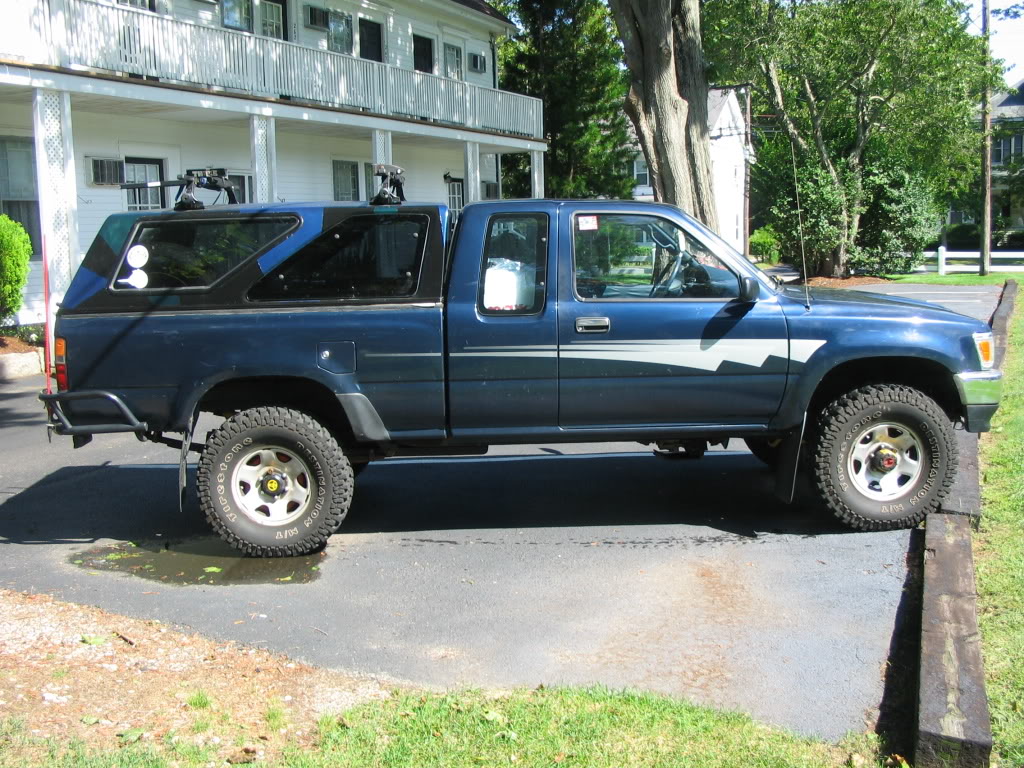

Spearo, that is a sweet rig.

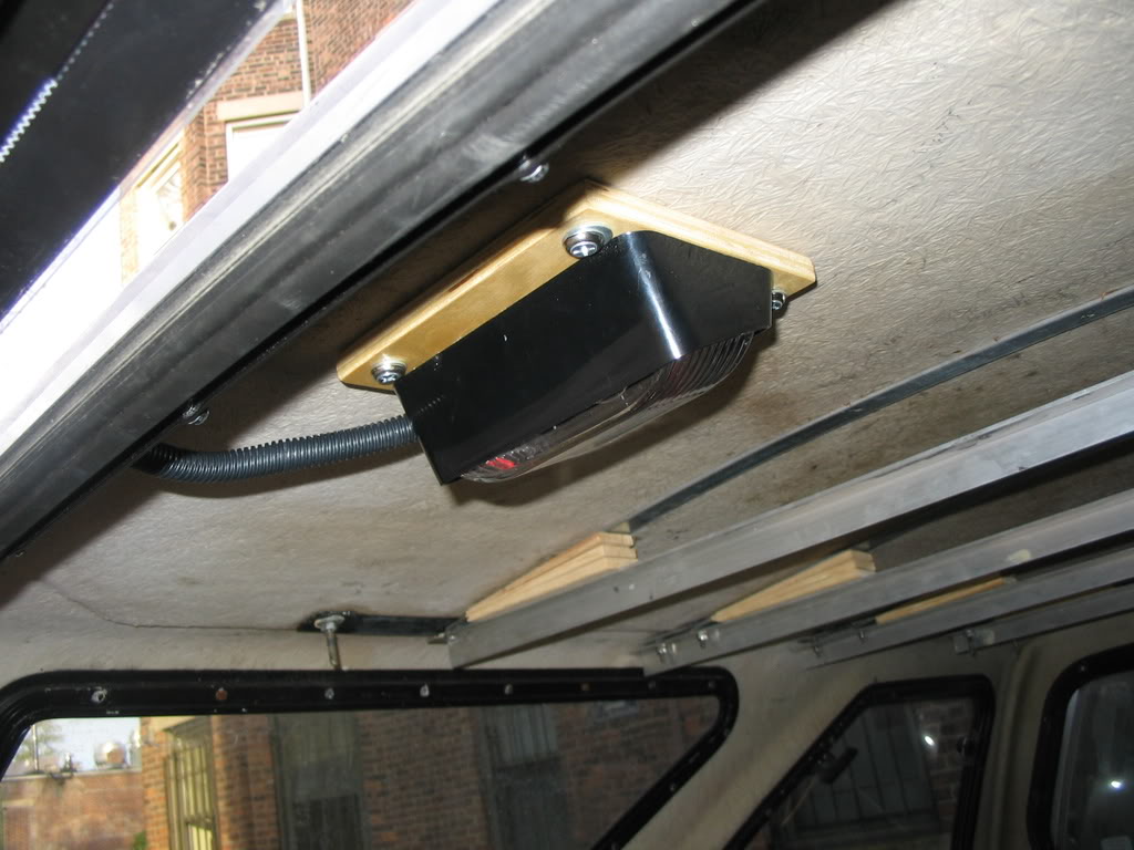

Below is some of my stuff. Hidden is OME lift kit & steering stabilizer -- the latter the best 70 bucks I've spent in a long time.
Since the pics I have put in a BudBuilt skidplate and Xmember, and have a Badlands Bumper on the way

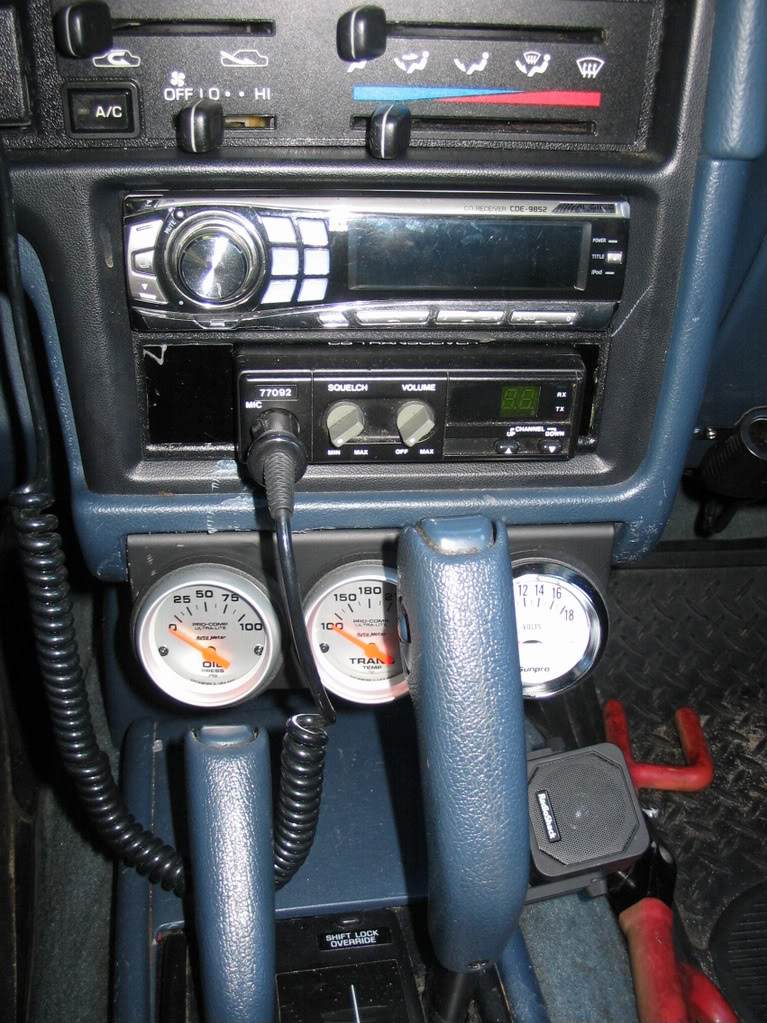

i like that instrument cluster there, did you make that custom?

Yes that is custom.

Sort of at least. The 2 left gauges are cheapest Autometer I could find, the right most a cheapy Suntour. All 3 are electric. The mounting panel is from Autometer. The spot is where the ashtray used to be. Cut it out with a dremel. Used plastic screws as well as RTV gasket sealant to secure the panel in place. Power via a Painless Wiring fuse block.

I love the shell in that picture. I was actually going to start a thread about a ZR2 looking shell, but now I know they make some that look pretty darn close. What brand is that?

Duper -- the shell is an old (like 15 years or so) LEER cap. Don't know if they even make these any more. Leer kinda sucks for service as they only go through dealers, and I had a huge hassle when I had to replace the back window. The roof started to buckle due to a poor seal job I did on the roof rack, hence the "artistic" bracing.

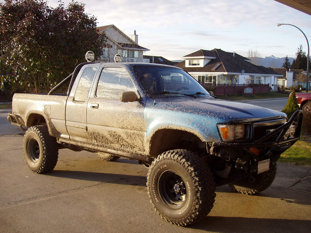

My junk

American racing steelies? they look like my 767's. Love that front bumper, I think that might be the next addition
