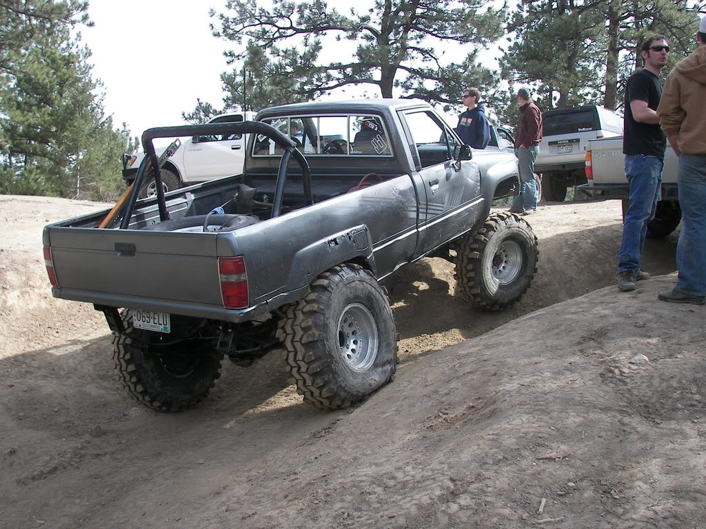

I wound up doing this and im looking it up to get the measurements again so i dont have to bring my truck to the shop to do the new bed. Heres how she looks and is having a bed and cab swap right now so he will be painted all purdy and not rusting.
Where are you guys measuring from? Before i just measured a foot and removed it.
